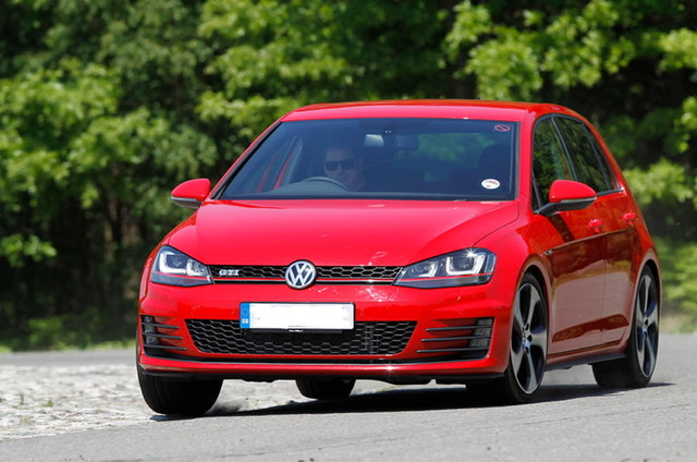

If it’s a UK spec mk7 GTI, it should have xenon headlamps (standard on UK GTI’s) and ‘U’ shaped DRL’s and the red grille stripe extends into the headlamp units - like the car in this picture;

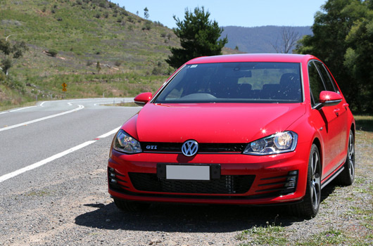

Some of the car supermarkets in the UK have had batches non UK spec imports for sale at various times that have had halogen headlamps. GTI’s with halogen headlamps also don’t have the red GTI grille stripe extending into the headlamp units. The mk7 GTI in the picture below has halogen headlamps;

Thanks Everyone, the lights look like those on the top car so I am pretty sure that it has HID
