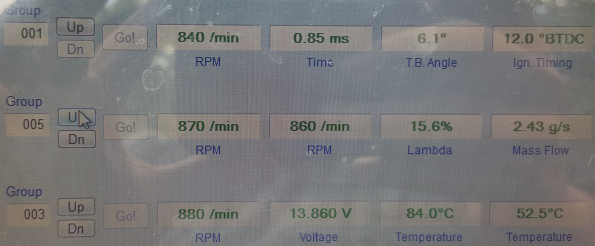

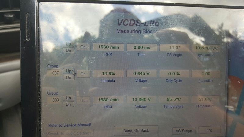

Hello,
Can anyone tell me if these lambda readings are normal
The problem I am having is that the car smells violently of fuel at idle and sometimes hesetates under high load, the throttle also bounces when coming back down to idle
Fault Codes that came up do not seem to be relevant here as they relate to the ABS - which wouldnt intefere with fuel management at Idle
p.s - its a 1999 AGU engine

Can you do a proper log including MB7 for a drive. Only log MB1 and 7 so you have a reasonable sample rate and drive it for a few minutes when it's warm. Then upload LOG*.csv to a filehoster and post link here.
