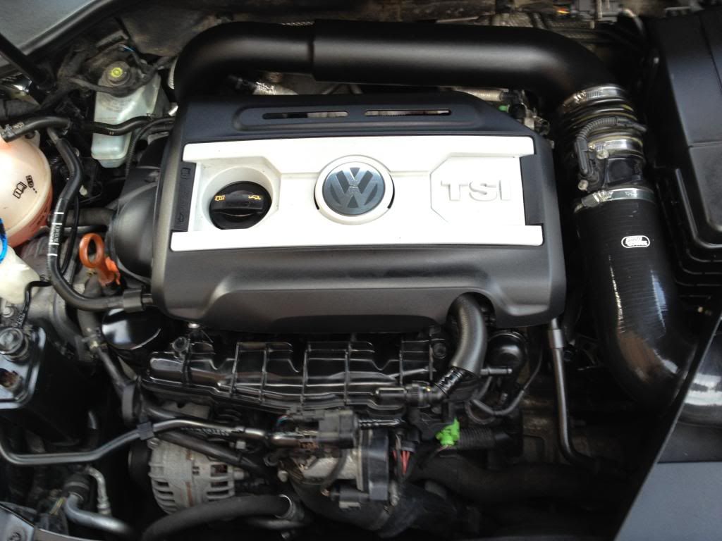

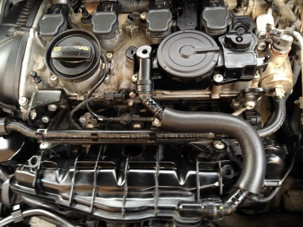

So over the past few weeks I have been noticing small irregular RPM at idle and small loss in power. So i popped the hood, engine cover off, and spotted oil near the filler cap and PCV valve.
So did the classic check, remove the dip stick whilst engine is running, didn't even flinch a bit, which in my past MK5 GTI means the PCV valve is shot.
Sent the pictures and a short email to my dealers and they confirmed Yes, its probably a PCV failure, got in next day to have it replaced under warranty. Only took them 20 mins to fit the new and off i went. It has instantly removed the irregular Rpms and full power and boost has resumed. So gave the engine bay a quick detail to remove all the old leaking oil. Now looking pretty good for a 5 year old engine bay.
You can see all the leaking Oil
Now all cleaned up and looking tons better

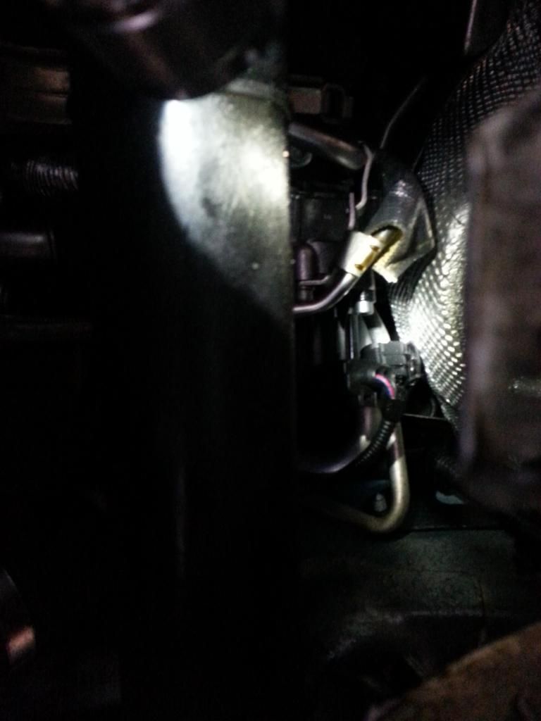

« Reply #155 on: 24 July 2014, 19:12 »
Oh fiddle sticks its back! :sad:
Just on this pipe though. (Better pic of pipe on page 1 of original leak)
cleaned the oil off it 2 weeks ago and its back again. :sad:
So need to pull the diverter valve to have a look.
May actually be this pipe built in mounting bracket causing the pipe to weep. (Most likely cause)
Anyone know the part number for this pipe and cost?
