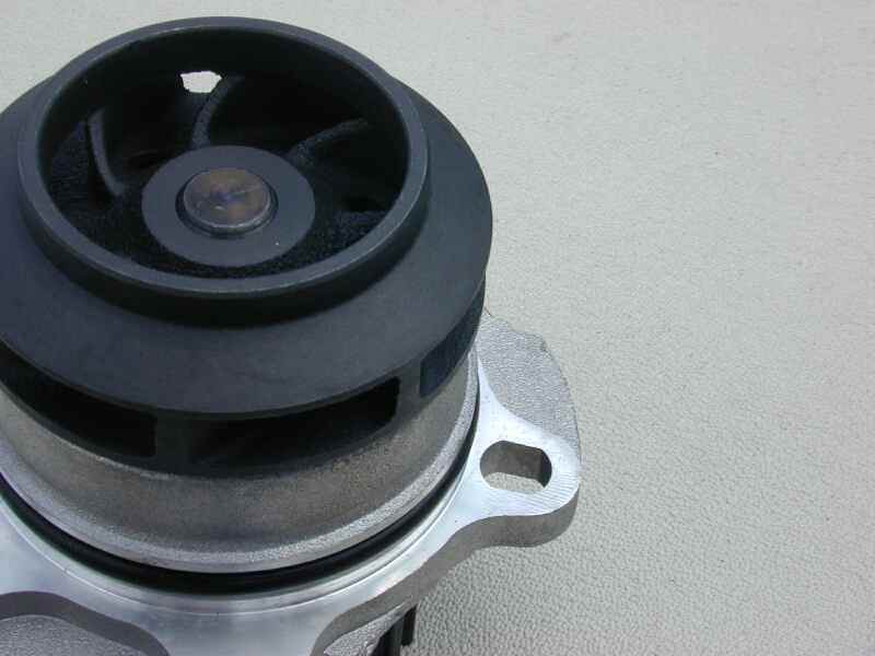

while doing the thermostat you can feel inside to see if the impellor is still there...

What's the  impellor lol

The black bit in this pic
It's what circulates the water around your engine. Usually they break apart or come away from the shaft meaning they will only sometimes turn.
