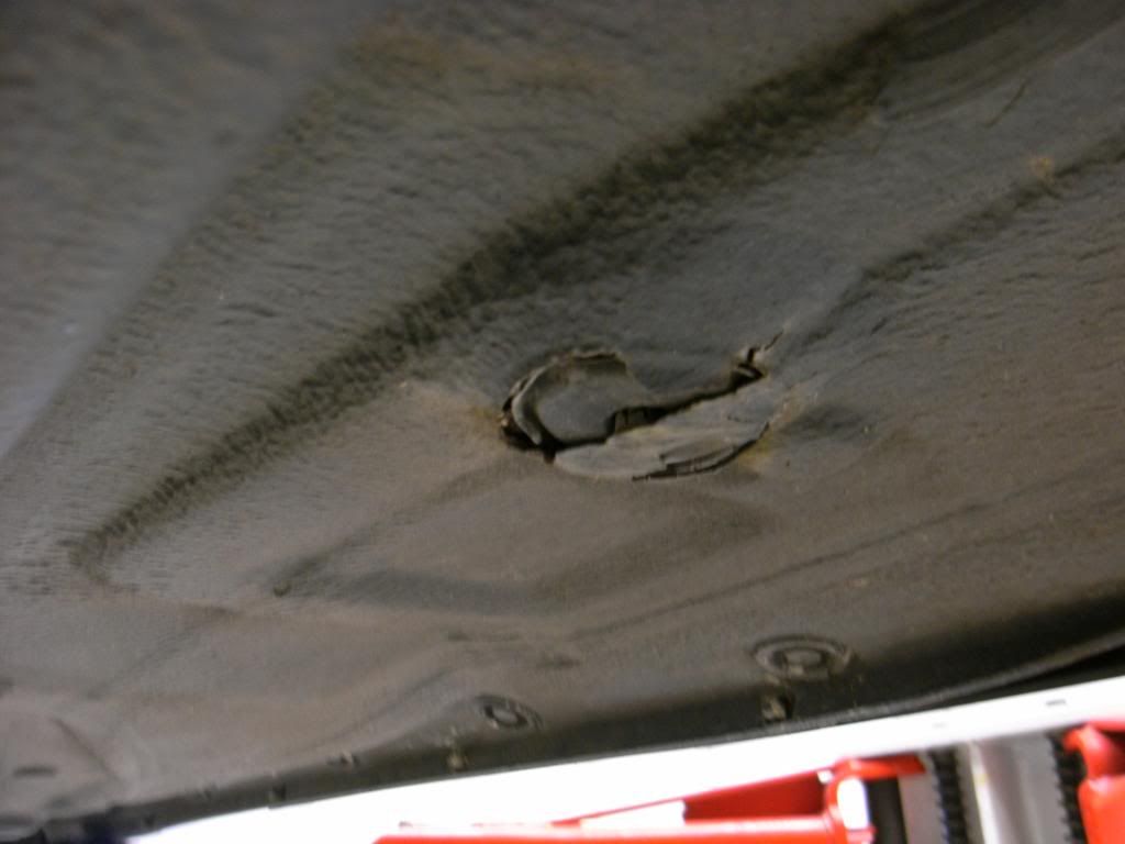

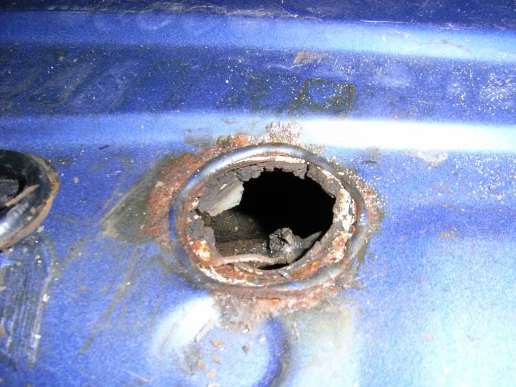

Oh also got a look at the other side of this:
http://i1017.photobucket.com/albums/af293/Daniel_Brill-Edwards/My%20Golf%20Mk3%20Build/RIMG0094-2_zps209389b9.jpg
And turns out it's this:
http://i1017.photobucket.com/albums/af293/Daniel_Brill-Edwards/My%20Golf%20Mk3%20Build/RIMG0011-3_zps39c4a601.jpg
Plan is wire wheel the surrounding area, put some rust killer on, loads of hammerite, silicon the bung back in then underseal

yeah i've got a similar picture on my floor but only the rubber grommet has deteriorated. i will try to find one somewhere or just seal it shut.
