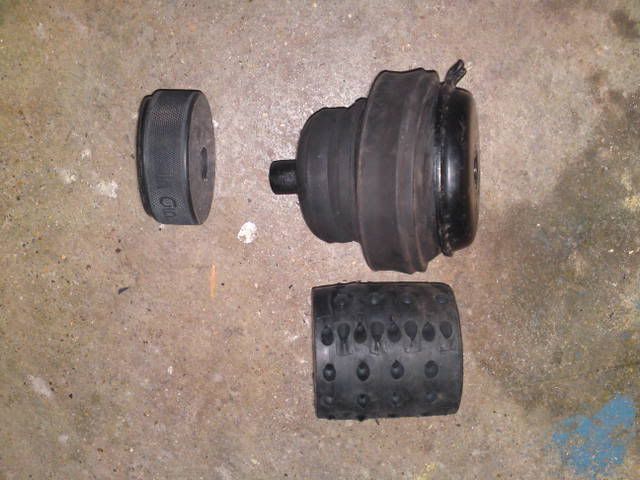

Original swiss cheese mount. Left is upper section. Right is Lower section

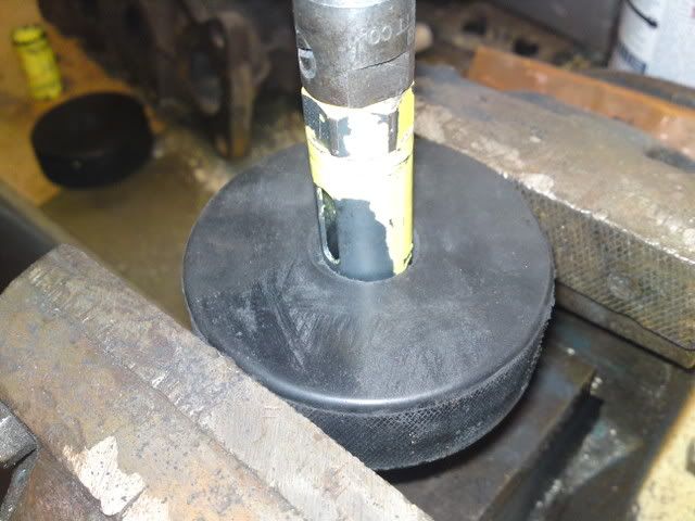

To allow the pucks to fit the mount body, they needed holes drilled through the centres. I did this using a 20mm Hole saw. and did all 4.
Drilling Hockey pucks with hole saw

Showing assembled mount and old swiss cheese mount

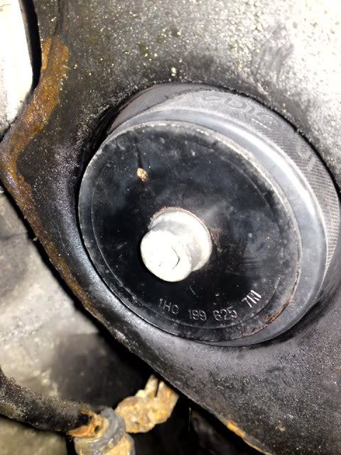

Mount was then fitted to car in reverse of removal. The lower puck was fitted to the bottom of the mount with the large washer .
Lower puck mount fitted
I found the engine has a lot less movement now and i can't feel any movement on overrun or accelerating. There is a slight increase in vibration but its acceptable :)
