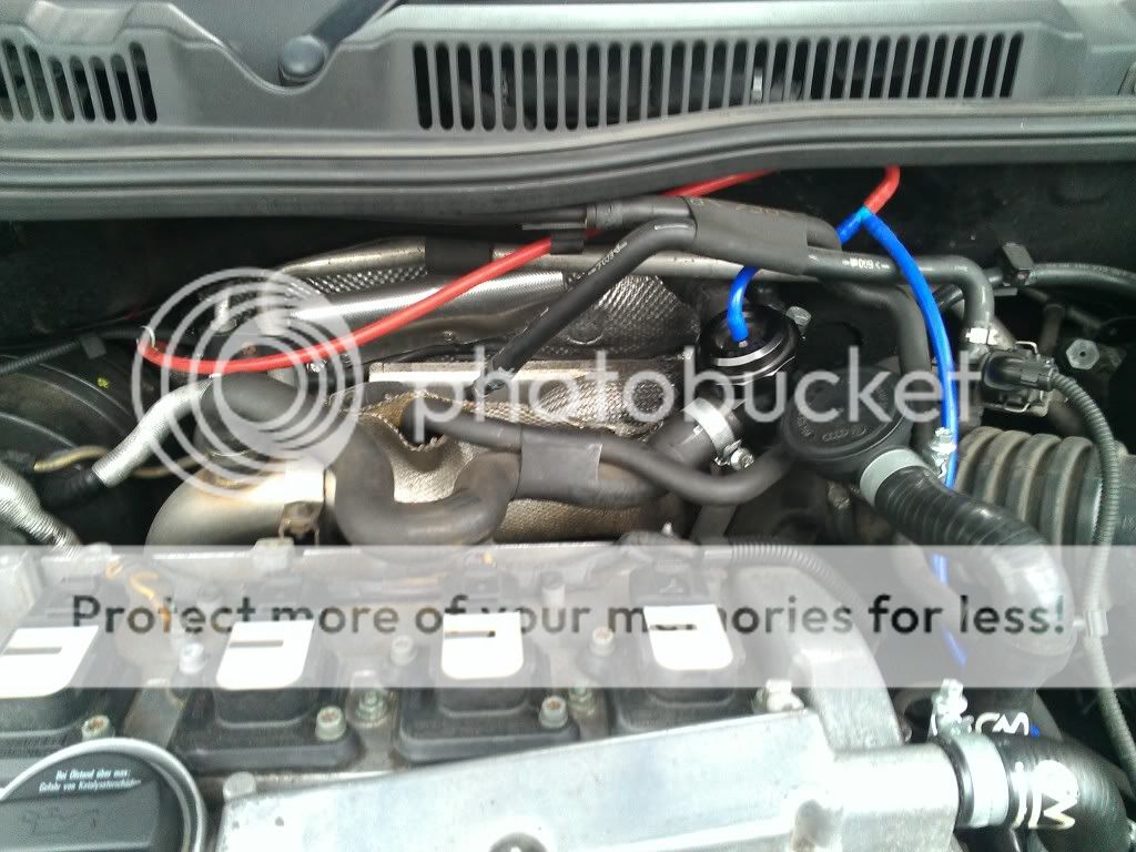

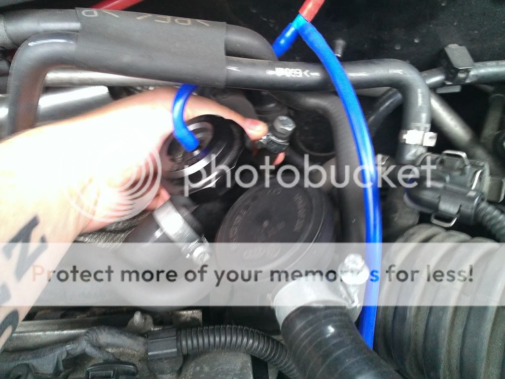

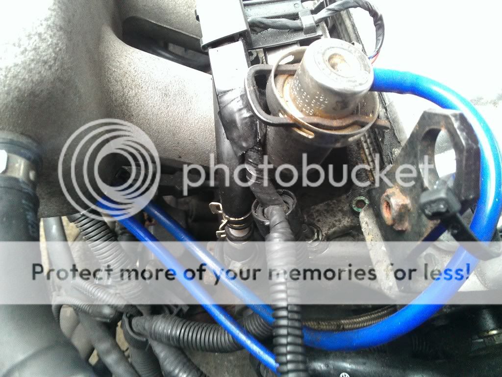

Hope these help - I tried to do them in order so you can see what goes where  :wink:
The one thats capped off (near the TIP) with a nut basically ran into the Carbon canister and the TB with a T piece, I did have the 8mm - 4mm reducer with the boost gauge on but it rattled like hell, and when I put it back to the DV thats when I noticed the boost hold better so I must have had a leak along that stretch

Thanks, that is a great help  :smiley: I am going to change my boost gauge to the dv like you have tomorrow as well as doing the cc delete. The place where my cc pipe goes into the tip is a bit further down the tip than it looks like on yours, I tightened it up the other day, but I didn't realise what it was!
