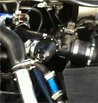

Okay, so I've been informed that my car has an atmospheric DV and this isn't good!
How hard is it to change this for a Recirc Valve?
Here's the valve that's on it, please help asap, as I'm worried now lol!

dv valve sits into the tip theres a pipe coming of the dv onto the charge pipe and a 3/4mm pipe coming out the top, route that to the fuel pressure regulater if u need any pics go through my dub rides thread

Its easy to change. Get a forge 007 (with yellow spring). What are the exhaust clamps on (a boost pipe). If so change them. You could be loosing boost there.  :wink:

Have a good look over your boost pipes and change all the exhaust clamps. Your DV will be fine until you get a forge one .I used to run blowoff valve on my AGU .But you dont know what spring is in it. Yours must be mapped to get 11psi so get a yellow spring with it.  :wink:

this 1  :smiley: from awesome gti
http://www.awesome-gti.co.uk/product.php?xProd=3714&xSec=9920
what spring would he need. I have yellow on stage 1 ,but it says green 8-15 psi ,yellow 15- ?? psi.  :undecided:
