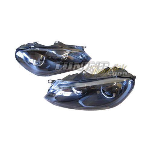

- How easy are they to install and what parts do you need?
- Any error messages on the OBC?
- Are there different versions of the light units (adaptive, static, auto highbeam, etc)?
- Is everything contained in the headlight units, or do you need to buy and install the ballasts and other gizmos separately (if so, where are these located in the engine bay)?
- Are the connectors the same as those on the standard halogen lights, or do you need adapters?
TIA :smiley:
P.S. as I have the winter package, I already have the washers in the bumper

Thanks for your reply, but I really want the genuine OEM xenon headlight units rather than just the 'bulbs'.
You can find brand new original VW units on the German eBay for about £700 a pair, but I need to know if they are plug & play, or a pain to install.
