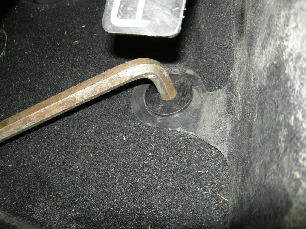

To take off the side kick panel here's how!
Then there is this thing under the accelerator!

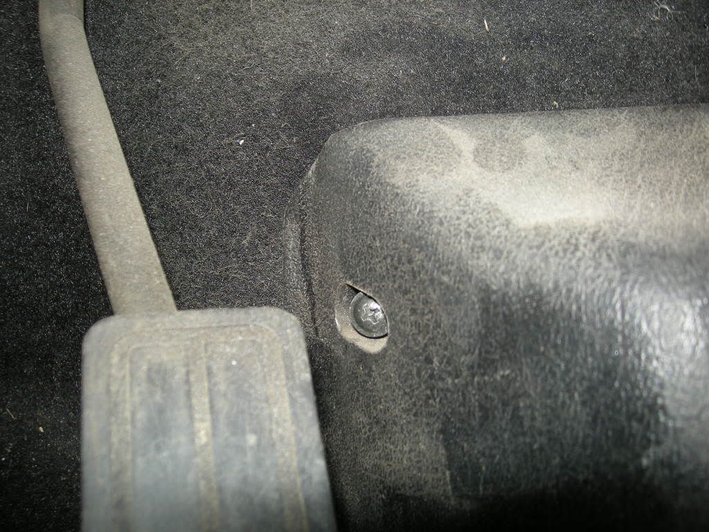

This screw!
