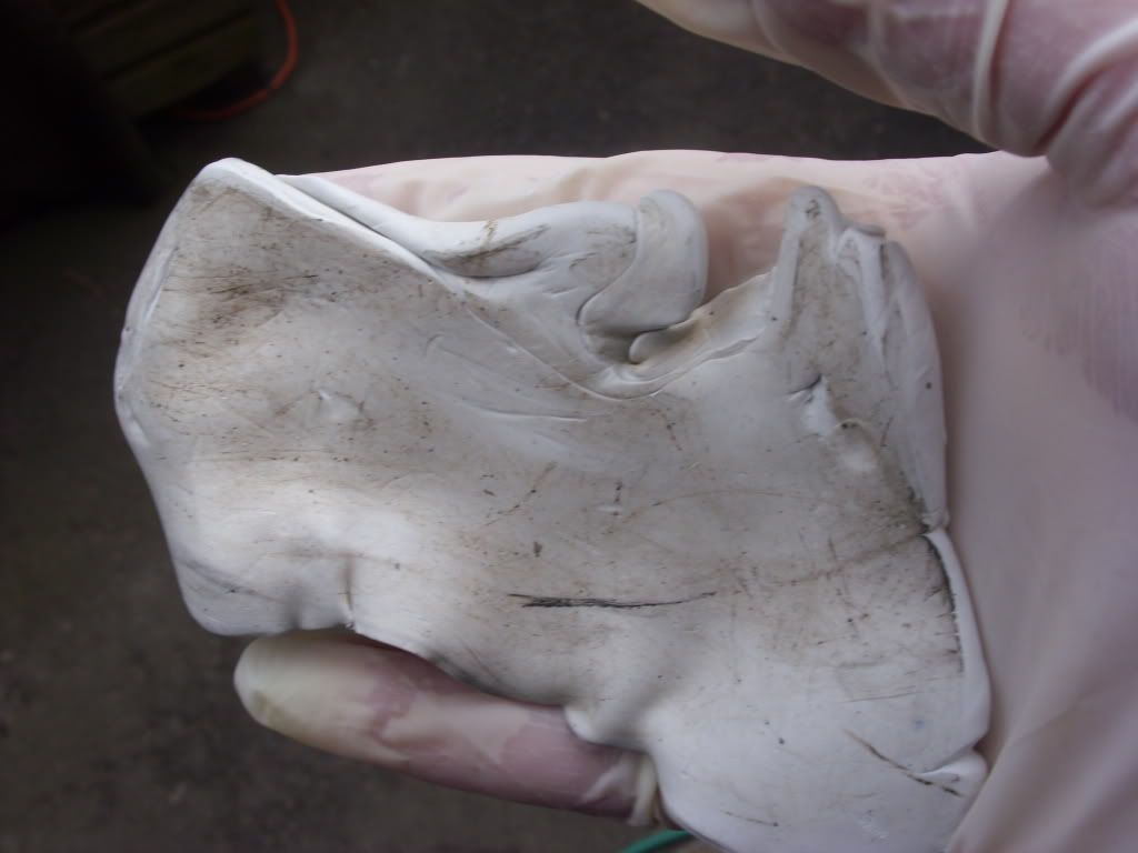

Then it was on to the claying, I used the Megs quick detailer with a the Megs clay bar, every panel was looking like this on the clay:

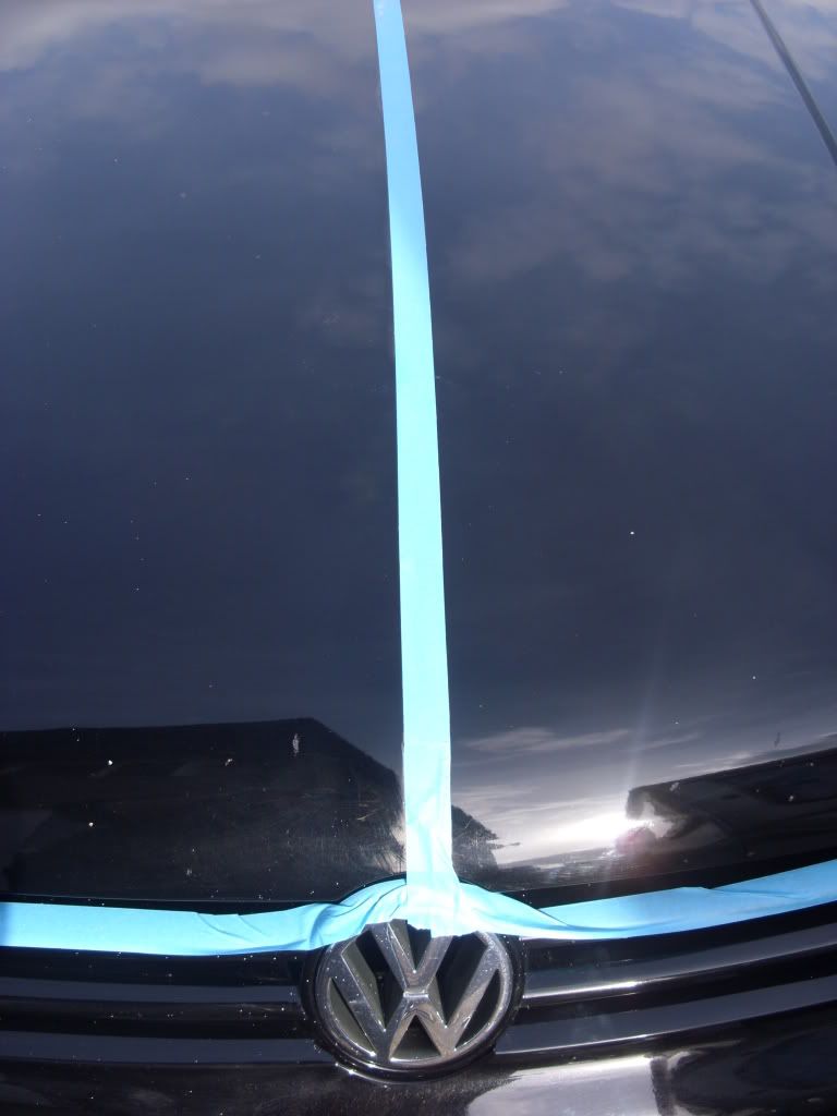

Taped up with 3m. Some areas were going to need more attention than others:

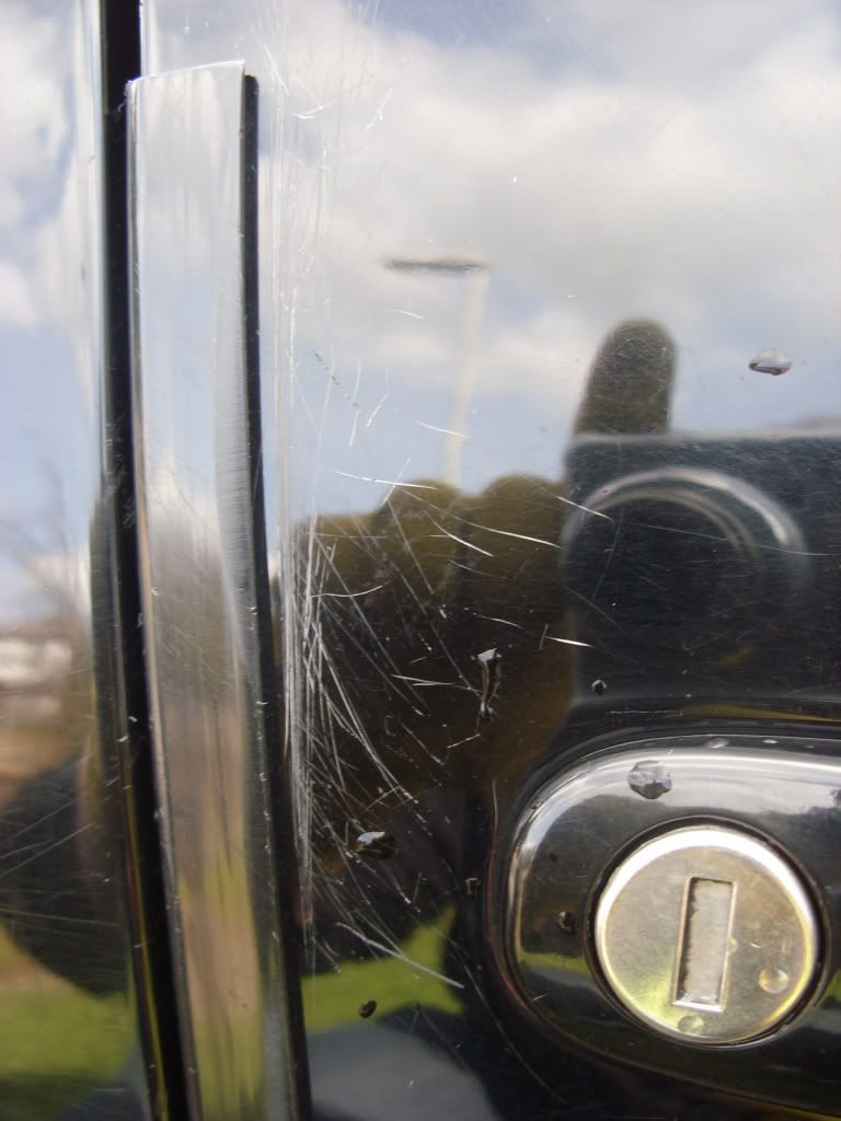

For the bad door scratches I had to step up my skills and opt for the wet & dry method. I had recently brought some Mirka Abralon sanding discs from Polished Bliss 2000/4000 grade. I used the 2000 first and finished off with the 4000. Polished out using the G3 and then the Megs #80
Before

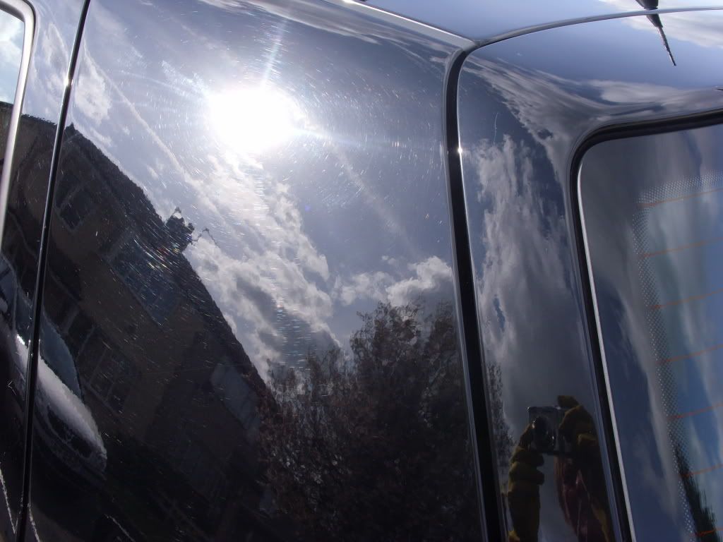

After

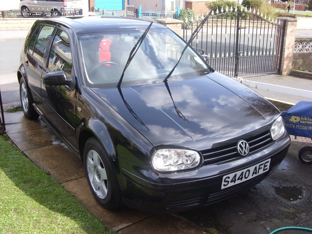

Some before and Afters
Before
After

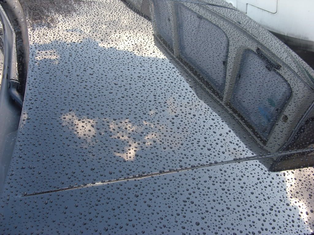

Some nice beading and reflextion shoots

The scratches are from the key, god knows how or why she kept the key open when it folds away nicely.
Nearly ever door had them :angry:
