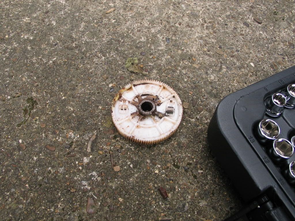

Has anybody out there got a non working rear wiper motor. Now that's not a request seen very often on forums. The problem is my wiper motor stopped working so I removed it and stripped it down to find that water had got in throught the shaft and made it very tight. Because the shaft was tight the motor was working very hard to turn the flat round nylon wheel under the cover and now it has no teeth left on it, hey guess what it is not supplied from VW. They can supply a repair kit which contailns a shaft, jet and new seals but no nylon wheel. So you can see my problem, I have a perfectly working unit with a duff wheel. (a new one is £87 from VW) and a second hand one is £45 and I dont need 90% of what's in it. Might seem stingy to most but if anybody has an old unit where the wheel is ok I don't mind paying for it.

the problem you've got is that there are 2 size nylon wheels depending on who made the wiper motor.
do you know which one yours is?  the part numbers are different as i might have a spare one depending on which brand.

I removed the motor cover tonight and here are the numbers from the casing.
It is a Bosch motor   ADO 12v 0 390 201 557
                           VW 1J6  955  711C
