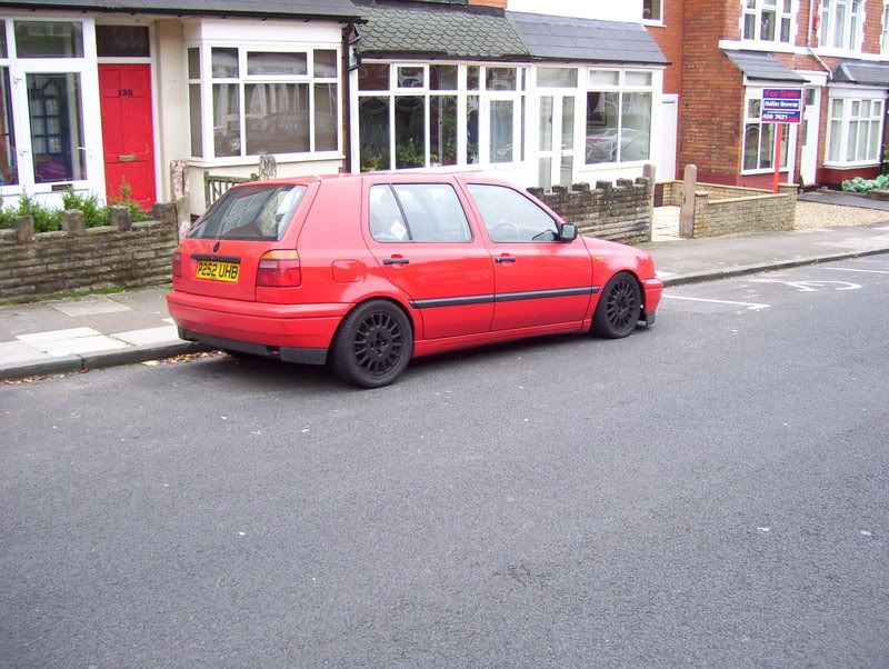

I'm afraid I disagree Shep
After seeing this picture I got my hands on some Sebrings, although 15" wheels meant 'bye bye exhaust' so I put my 17's back on.
