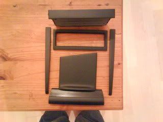

The cup holder just unclips either side like headunit i found the tool that comes with a headunit very usefull to get it out,
so when i had finished i ended up with this

Heres everythings ready for priming- (Make sure you wipe the excess dust off everything first, do this with a wet cloth or somthing)

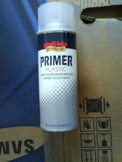

When everything was clean i started to prime, i used a palsti-kote plastic primer again from B & Q
think it was like £5 or something like that.
i actually thought it would be grey but its clear oh well...

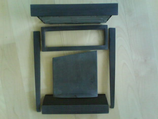

And heres the result after the first coat,
I left it to dry for about 2hrs or so then i sanded it down again but this time with a finer grade,
then i gave it another coat
thats as far as im upto at the moment,
ive got to get my finishing coat sorted thinking of a matt black i will try and finish it
tommorow if my head lets me  :laugh:.
The Finished Product
