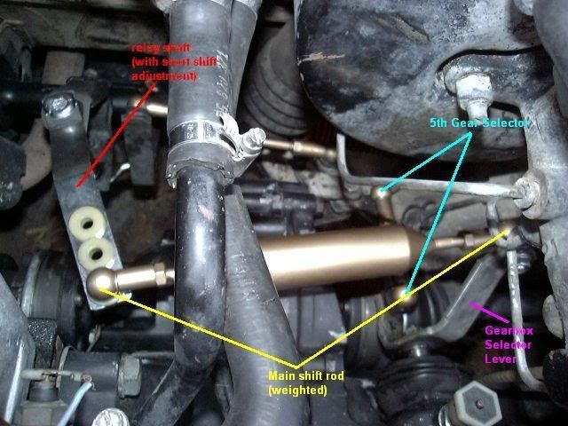

is the 5th gear linkage still there, its a common fault, wee plastic arm breaks easily.

Where abouts is the 5th gearlinkage ?
Gambit
Forum addict
Posts: 4,354
Re: Gearbox Disaster-Please help (location of 5th gear linkage ?)
Reply #12 on:
03 October 2007, 10:37 »
this is an uprated linkage on a left hand drive car. but it shows the 5th gear selector. in your car this will be plastic.
cheap enough to replace if broken
