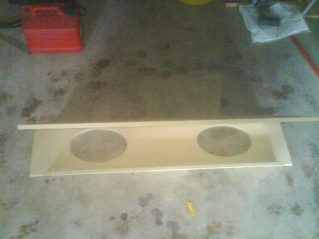

First step was to measure out the top and bottom and cut out the holes for the 6x9
Then I cut out the front and stuck it to the top

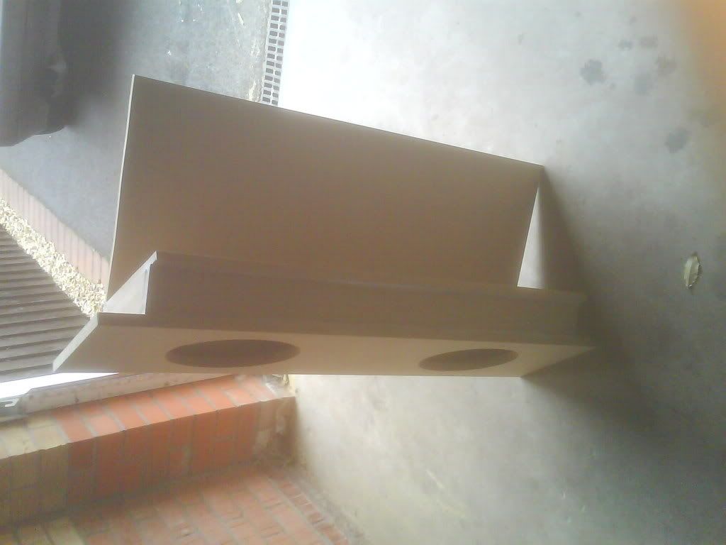

Then I glued the back on, I didnt it all in one sheet because the lower back would have the amp attatched and I initially wanted it to be straighter than the front
Then I glued the sides and bottom to the speaker enclosure....still needs trimming down at this point!

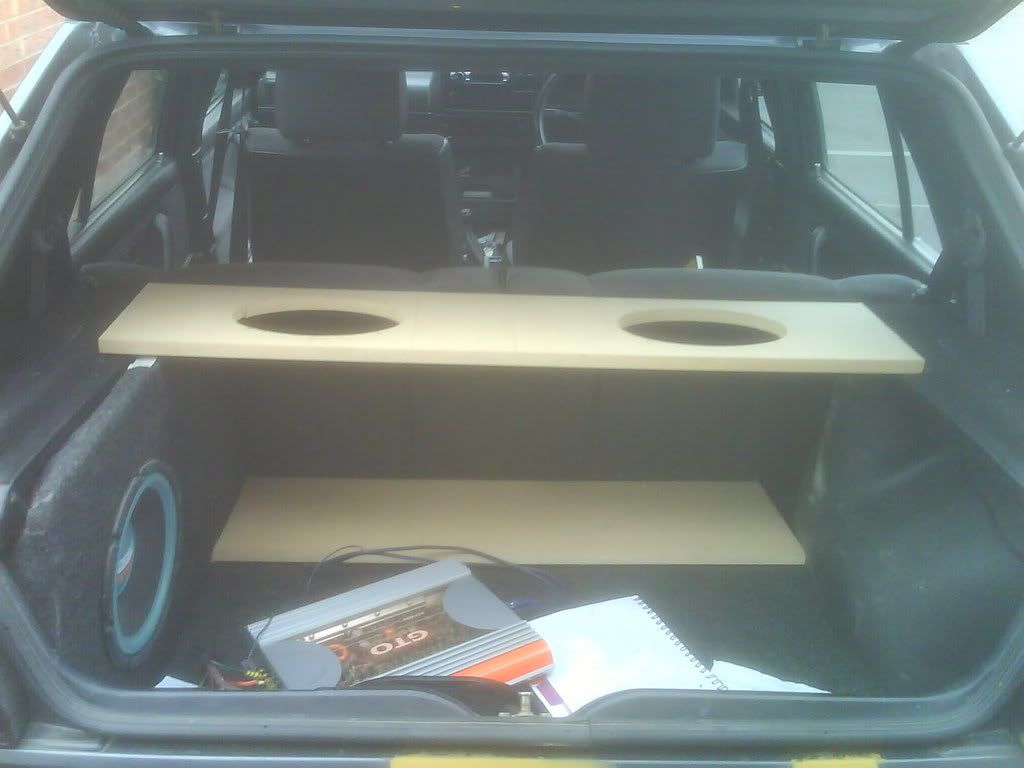

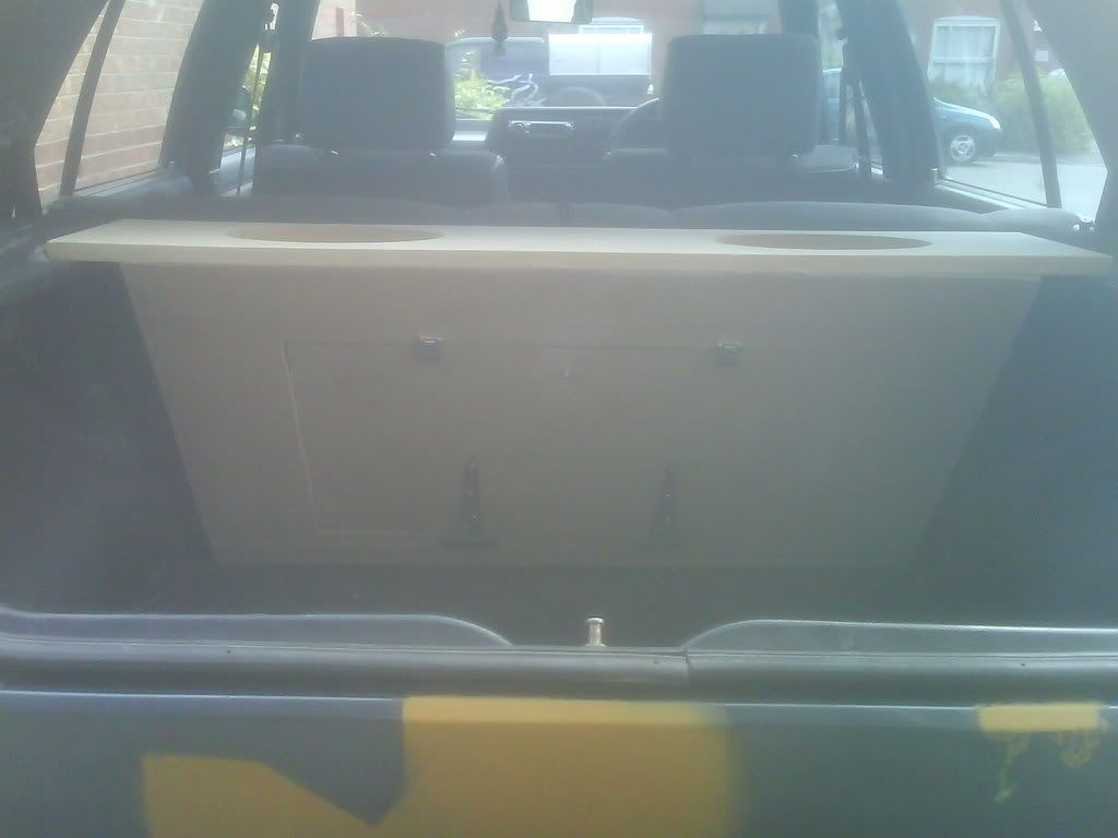

This is how it looks at this point in the boot

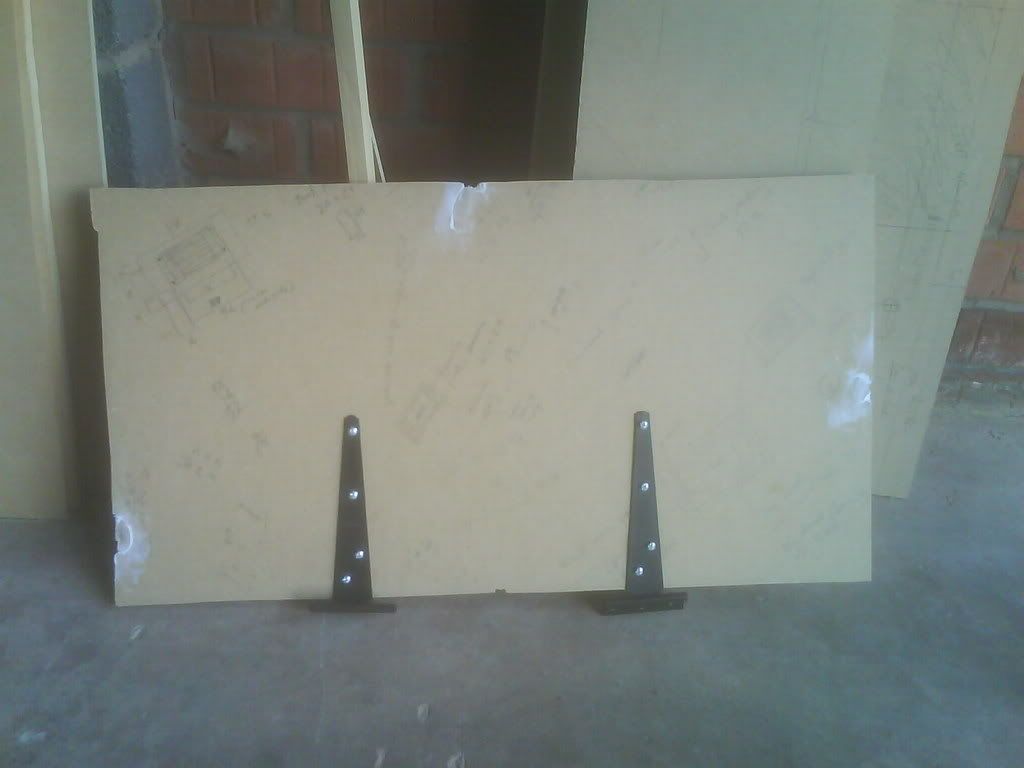

Next I cut the door out and attatched the hinges. I wanted these to be flat as poss so that when i cover it with carpet they wont bulge out. This is why I didn't use normal house door hinges. Had a few problems cutting it out at the 30 deg. angle because the blade kept hitting the speaker enclosure...Hence the filled holes!

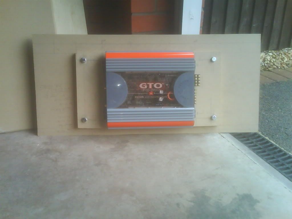

For the amp I decided to attatched it to a back plate that would be the same height but wider so that I would have more width to fix it to the back of the box. Decided to attatch it to the back of the box with some big chunky bolts and glue the nuts onto the back of the box to hold everything in place.
This is it all attatched to the back of the box (yet to be glued on) with the chunky bolts

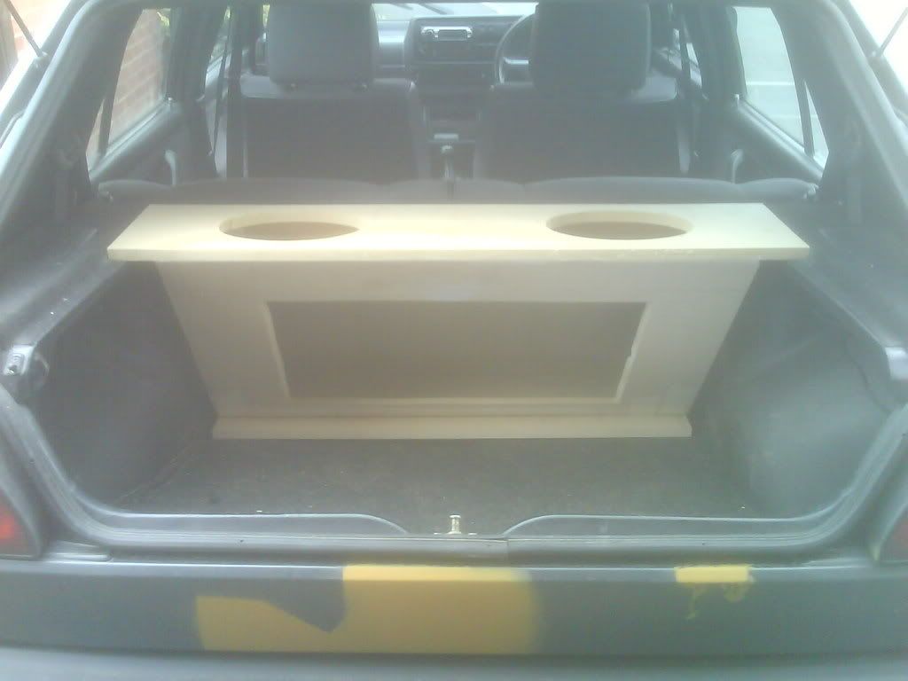

This is how the box looks in the car with no door!
Because the box is at an angle and the hinges are at the bottom the door doesn't stay closed so I needed some latches to keep it closed while I'm driving about. At this point the back and base of the box had been glued on so it was pretty much done!
So this is it in the car..no speakers yet though!

This it from the back. You can see the 4 nuts that help hold the amp in. I drilled the back sligtly so that when I glued them on they would sit in rather that just be stuck on.

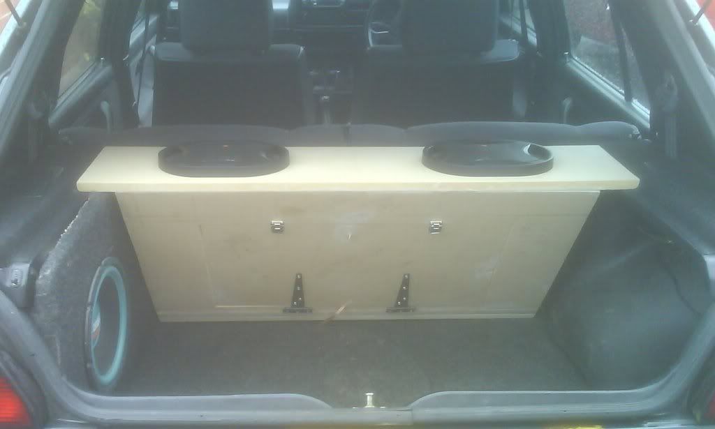

And this is it all done, in and wired up!
But of course it still needs finishing off. It needs to be covered in matching carpet which will hide all the gaps, bodge jobs and glue! Oh and the hinges. Once covered I will re-attatch the catches and a smart looking handle so they will be the only thing you will be able see when all closed up. I need to run the power cable down the other side of the vehicle after reading a post on that (really should do all your homework before starting!) and need to tidy up all the wires inside. And finally I need to fill that other wheel arch well with another sub to make it all symetrical!
