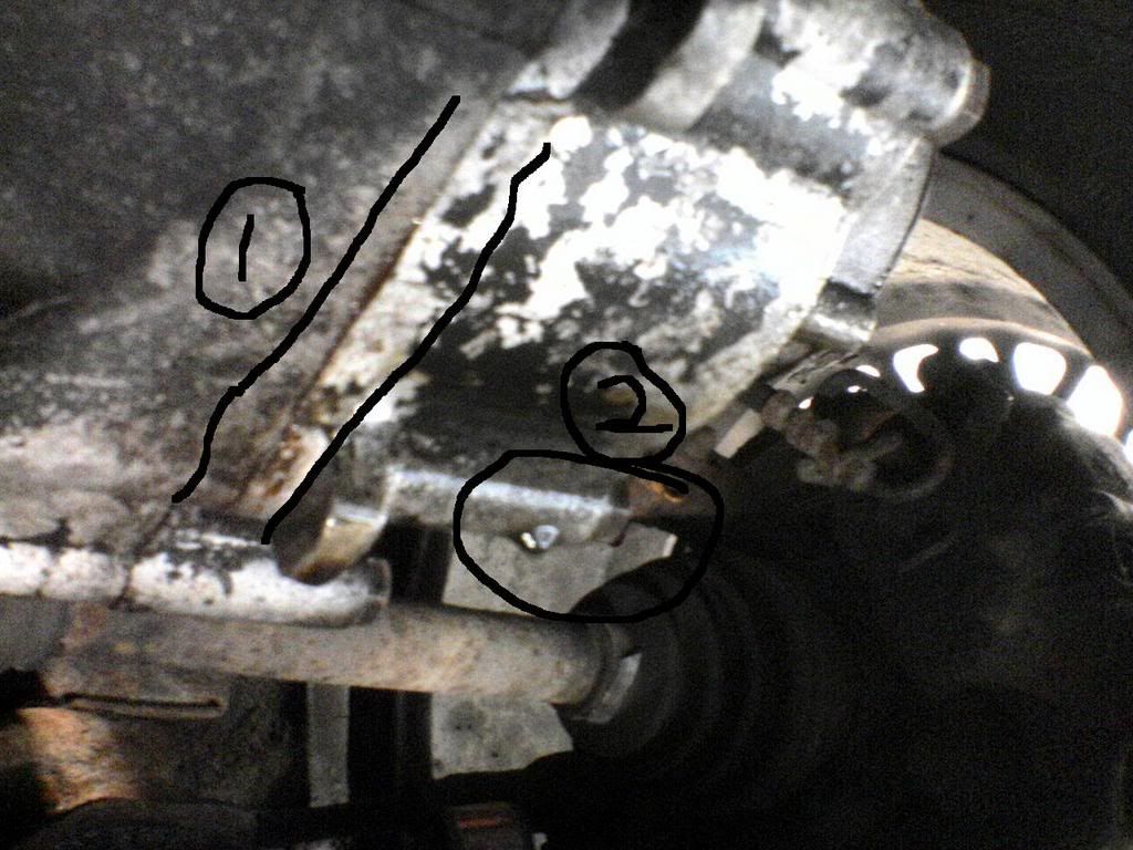

i have had a look under the car and can see drips comming from a joint (1) also there is a drip towards the end of the box nearest the wheel (2)
will i need to take the box off or is there a simple fix for this problem

just been under the car again!! for further inspection the puddle on my drive i think is down to the drive shaft seal on the drivers sid( theres alot of oil present here ). will i need any special tools too replace it??

they can be a nightmare to do, i had to do mine the other week and in the end it turned out my gearbox was knackered! if there is any play in the drive shaft flanges its not looking good!

Brought my self the new seals ( was feeling pretty confident at this point having decided too do them both! ).
Have spent the whole day under the car which has turned out to be a nightmare of a job. have got to the point now where i have put in the new seal after stuggling for about an hour to locate it ( the propper tools would of helped though my huge socket eventually managed too do the job. The ony trouble now that ive got is refitting the flange and getting the circlip back on. Due to the huge spring behind the flange its going to be a buggar. Im some how going to have too make myself a tool to push the flange in whilst i refit the circlip.  :cry:

yeah its a f**k*r, i had to make a tool as well :(

got all the bits i need including a new gasket from vw as the other one was nackered. tool neally complete. Am just gearing my self up now too finnish the job, hopefully tomorrow all being well.

job done yeehaa just in time for the show tomorrow. i think ill be leaving the other side.
