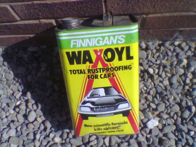

also while i was on the way to the training place i go to, on the estate i found this near a unit that was closing down, the guy said i could have it :smiley:
ive been told that if its used on an old car itll trap moisture and make it rust like a motherf**k*r, but on the tin it says that it can work on any car new or old and gets rid of rust aswell as preventing it
im really worried about it rotting away so i think im gonna pressure wash the underside and engine bay, then use this to keep it rust free, ive got roughly half a tin, 2.5 litres, will this be enough?

Chuck the tin and get yourself some up to date hammerite.lol :grin: :grin: :laugh:

Bin that Wax_oyl shat-pank - unless you're going to remove all of the under seal VW put on the car, but why would you want to do that, its serious hard work involving blow torches and lots of scraping with burning sh!t dropping on you and the wax-oyl isn't anywhere near as good as the factory stuff anyway  :smiley: - just touch up using your hammerite  :wink:

Is that a red bull can?  :shocked:   :laugh: :laugh: :laugh:

If you're binning the Waxoyl then gimme it! Blooming marvelous stuff! Inject it into the sills: it doesn't trap moisture and is almost the same stuff that the factory injected into the hidden panels when the car was built. Never had an issue with it in the (cough) many years I've been playing with cars and it's made by Hammerite!
