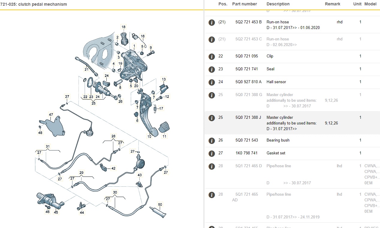

Offline EB2019
  • Posts: 267
Re: Clutch pedal annoyance
« Reply #4 on: 26 March 2023, 17:43 »
2 things spring to mind, if its just noisy, spray grease all pivot points, replace the master cylinder which is just behind the pedal.
« Last Edit: 27 March 2023, 09:55 by EB2019 »
