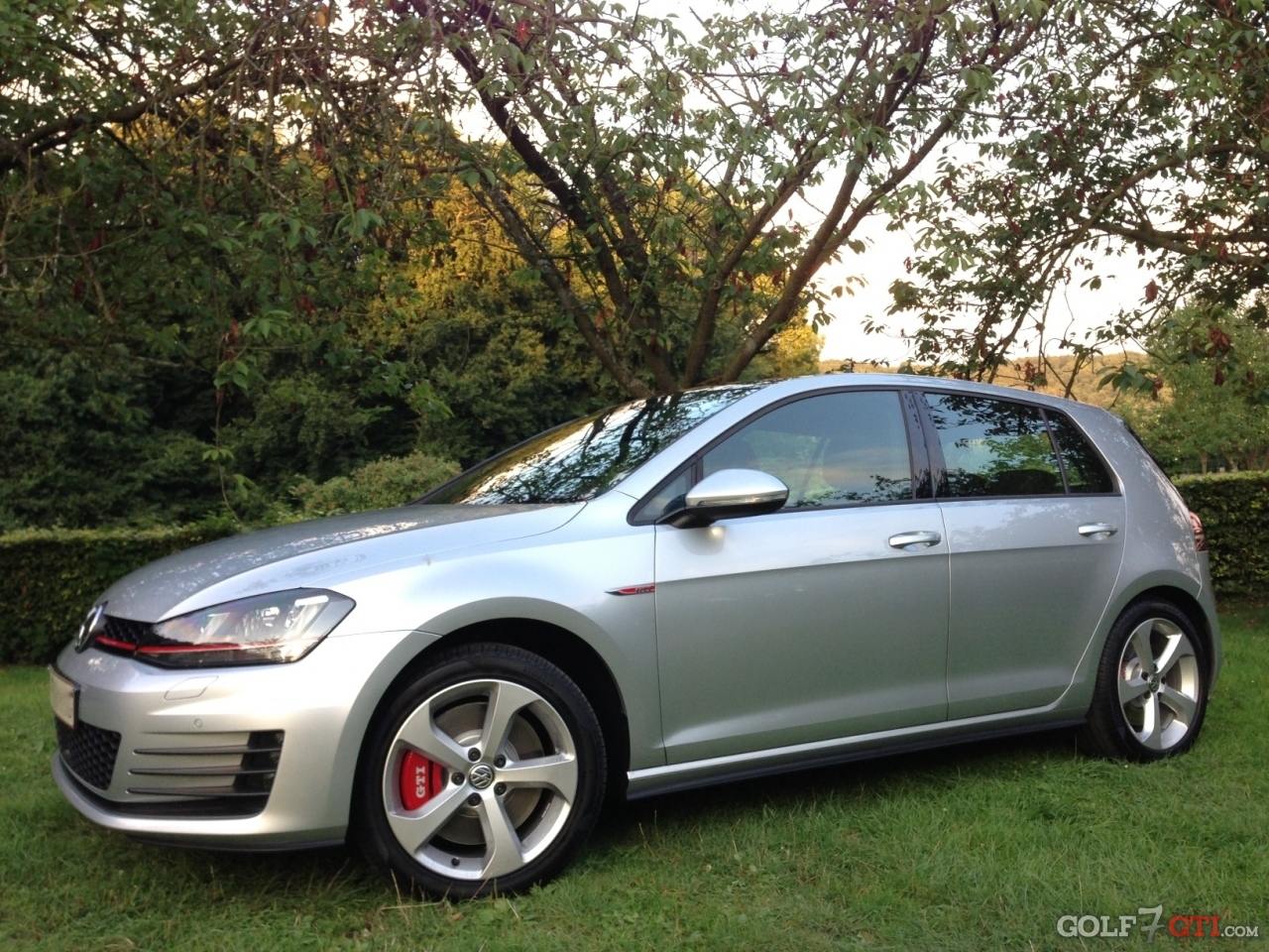

Thanks for the replies, I think the potenzas are pretty rubbish all round so a swap to PS4 would be a win win and might try that. I think lighter wheels might also help to get the unstrung mass down.
Not seen a 7.5 GTI  on 17, but I used to run my mk5 on 16s in winter and it was lovely. I’m guessing it’s tight on the performance front calliper?
I'm running factory 17's from the GTI in a bunch of other markets, so no clearance issues. I think most OEM 17's and aftermarket wheels in the right fitment are ok.
I went to PS4's at the same time but not from the original Flintstones so can't really comment, other than a lot of people have said they ride like crap and Michelin's are a improvement.
These wheels but not  my car.
