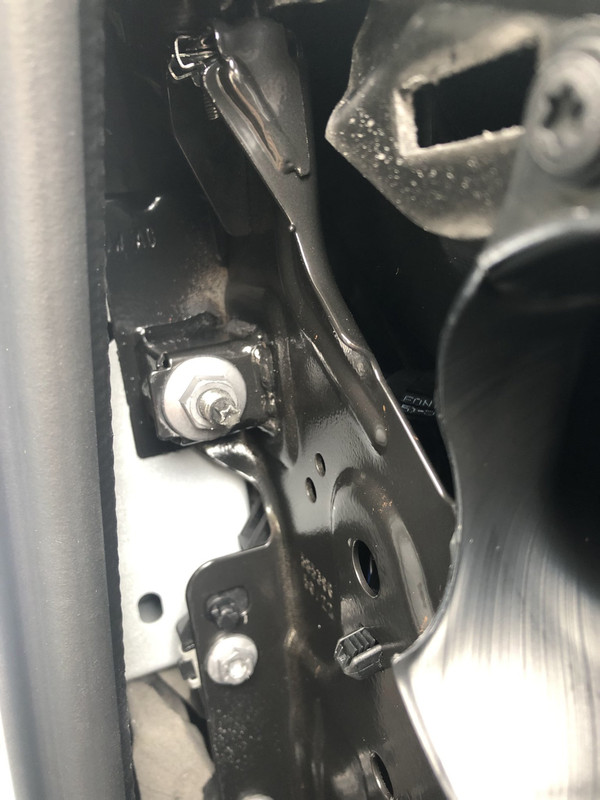

The dashboard chassis always looks scruffy with rust or discolouring around the welds - you're not meant to be in there looking is probably VW's attitude.
Been like that on MK7 Golf R, 2018 Polo GTI+, 2019 Polo GTI+, ID3 and Cupra Born that i've fitted dashcams to. The car isn't going to deteriorate, they just don't take too much care making it look pristine when no one will see it.
I expect to see the same when I fit my dashcams to the S3.

Fitted the S3's dashcam yesterday - the dashboard chassis was actually painted - that's a first, and it also made finding a grounding point for the dashcam a bit of a bugger. There were 3 bolts to choose from and only the top bolt was able to provide a decent earth.

Swapped over very easily.
Used the piggy back fuse.
No rust on the Audi at all. As said above, difficult to find a good ground as the dash frame seems to be hard plastic. Just need a new sticky pad now.
