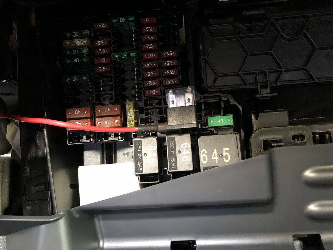

Yes, it should be that easy. The tricky part (which isn't that tricky) is popping off the side cap to the dash (a "D" shaped piece, that will probably have the switch for the front passenger airbag attached) on the side with the fuse box, usually behind the glove box opening. There'll be a 13mm bolt there on the metal chassis of the dash that mist installers will use as an earthing point, so will need to slacken that off and remove the earth wire), then remove the piggy back wiring into the fuses - a switched live, and (if the dashcam has a monitoring function) a permanent live.

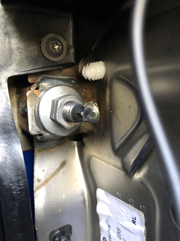

I removed the camera today and it was very easy. Just as you guys said.
They used a fuss piggy back to take power.
Now while I was in there I was rather concerned to see this surface rust on a brand new car!
  • Posts: 9,506
Re: Dealer fit dashcam
« Reply #17 on: 26 April 2023, 20:49 »
That’s not good to see.
I’ll check mine at the weekend.
Thanks for the heads up.
