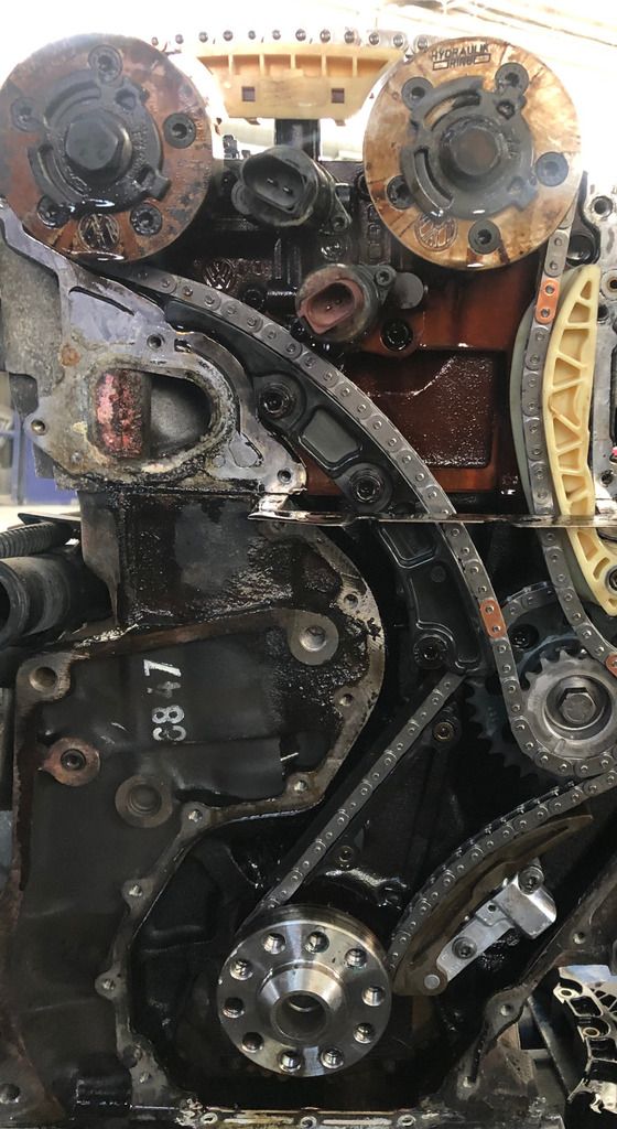

I'd been half looking for a while and spotted this one in Luton (I live in Cumbria), on paper it was almost perfect, 3 doors, DBP, Half leather interior, full service history, but no record of the chains having been done.
Someone went to look at it for me and checked the chains with Vagcom and the readings showed that they needed to be done so I made the decision to walk away.

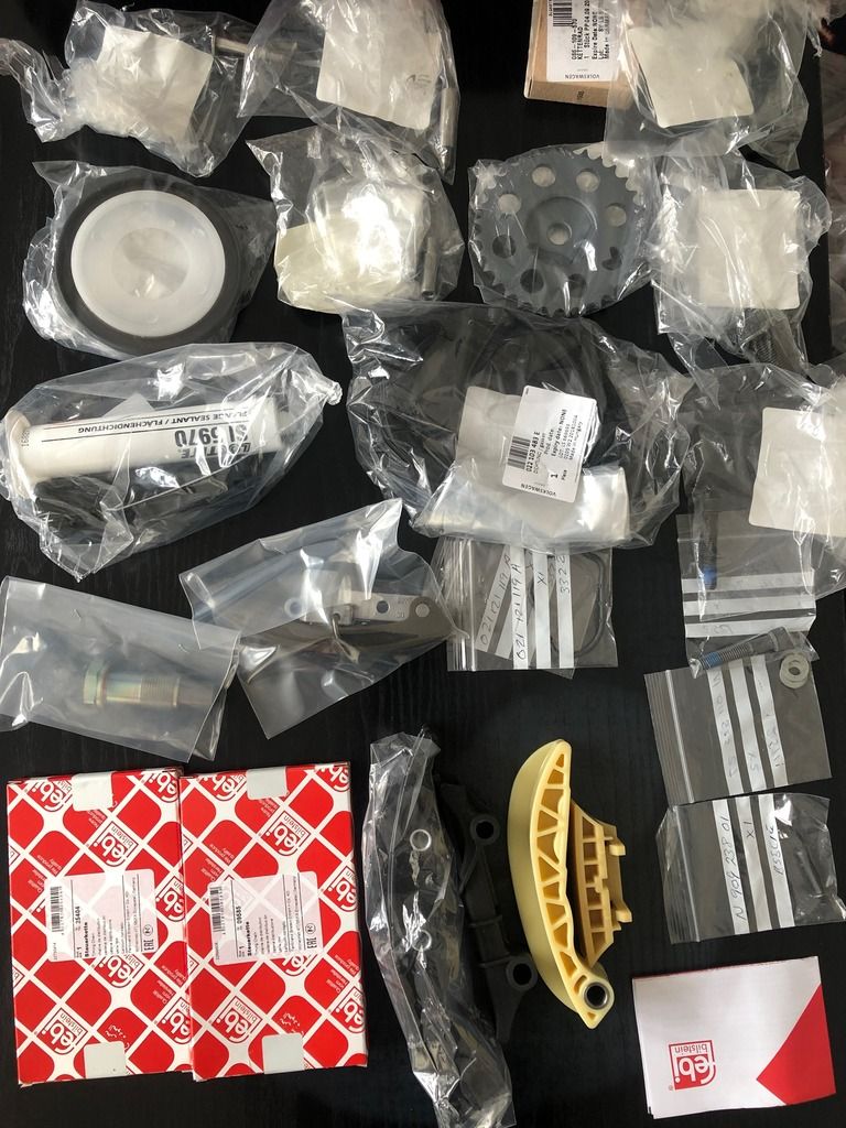

The seller then offered to get the chains replaced for a renegotiated price which i was happy with, I paid a deposit and booked a train for the following week.
The seller kept me updated with photos:

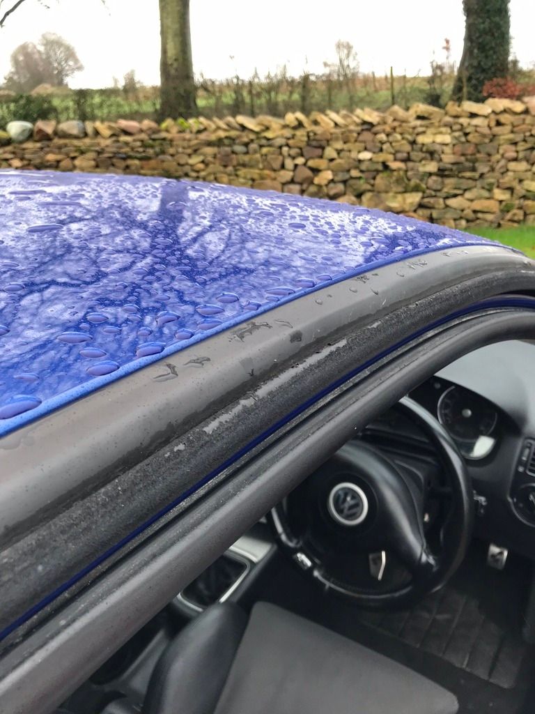

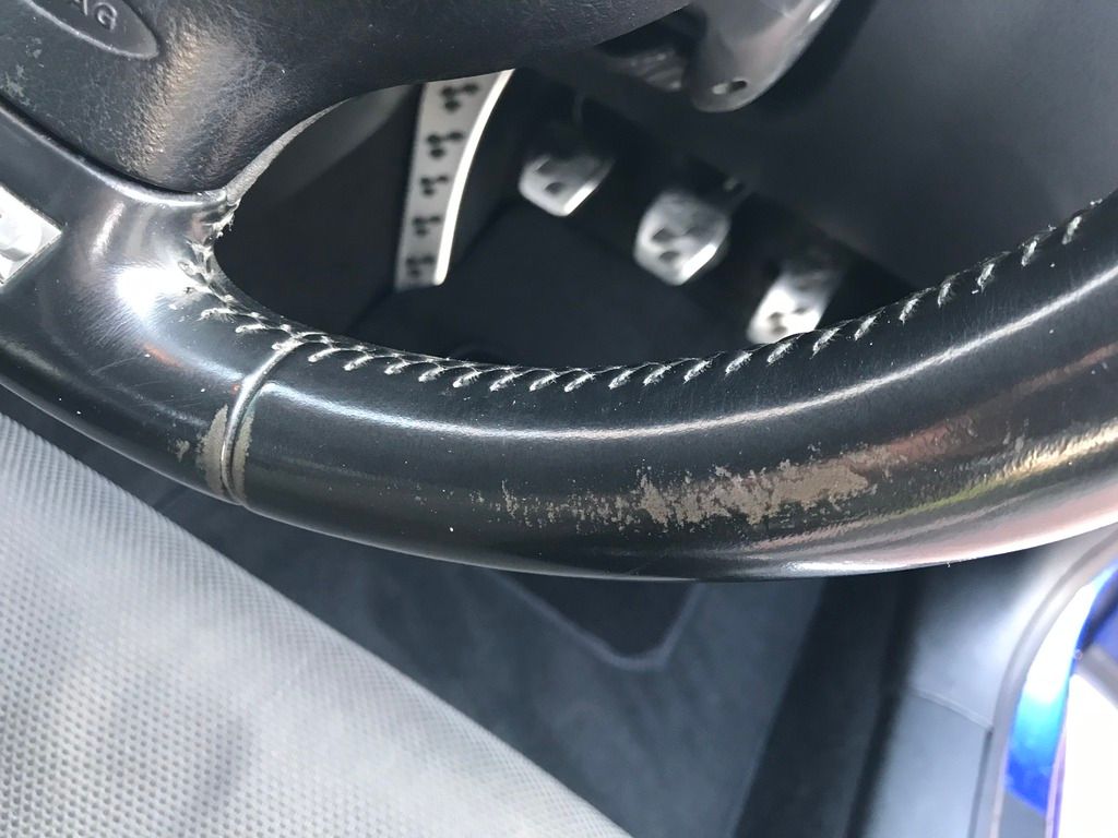

When I arrived to collect it I almost walked away again, the bodywork was mostly very good but there is rust showing around the handle on the tailgate and the rear bumper has had a really poor scuff repair.

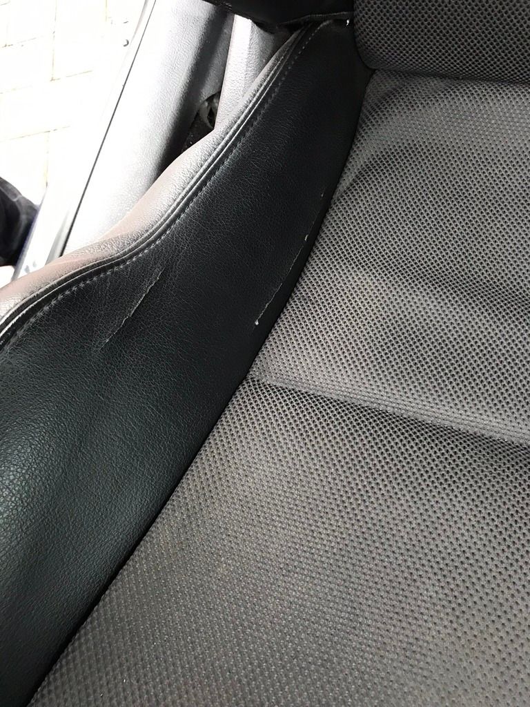

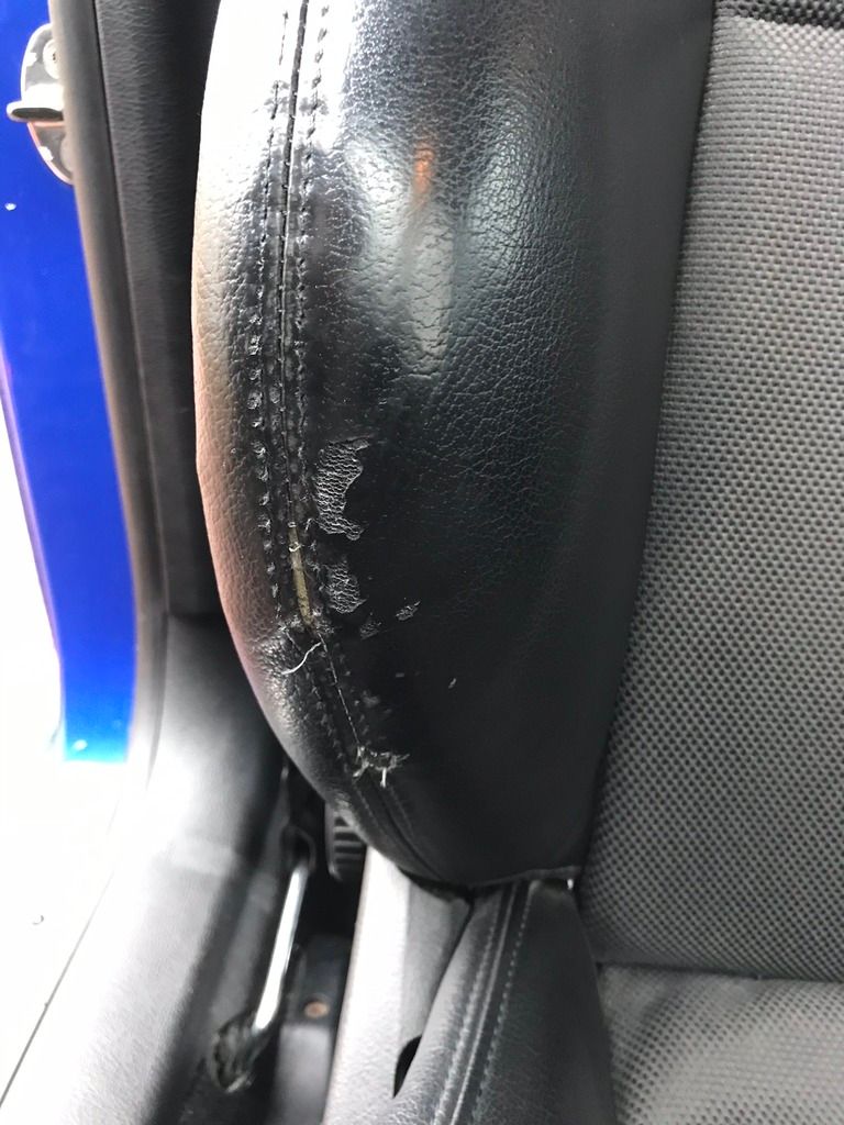

Inside was pretty tatty though, lots of scuffed trims, headliner filthy and has a couple of holes in, parcel shelf bent, steering wheel worn and drivers seat damaged.
But, then I took the car out for a drive. It's worth saying at this point that the car is fitted with a Scorpion exhaust with decats, that noise...wow :evil:
I had a long think about what to do and then realised that I was being an idiot to contemplate not taking it home. The interior bits and pieces can be sorted and what 16 year old car doesn't need a little bit of bodywork sorting?

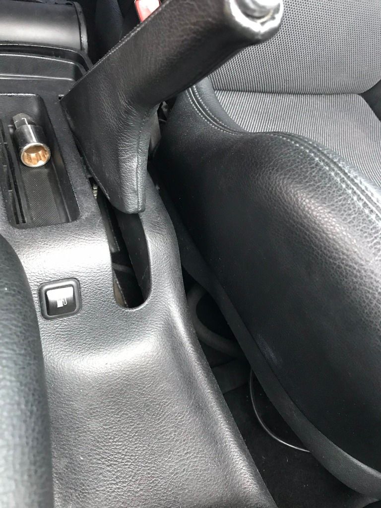

First, the car almost rolled down my driveway when I pulled the handbrake up:
That needs some attention then!

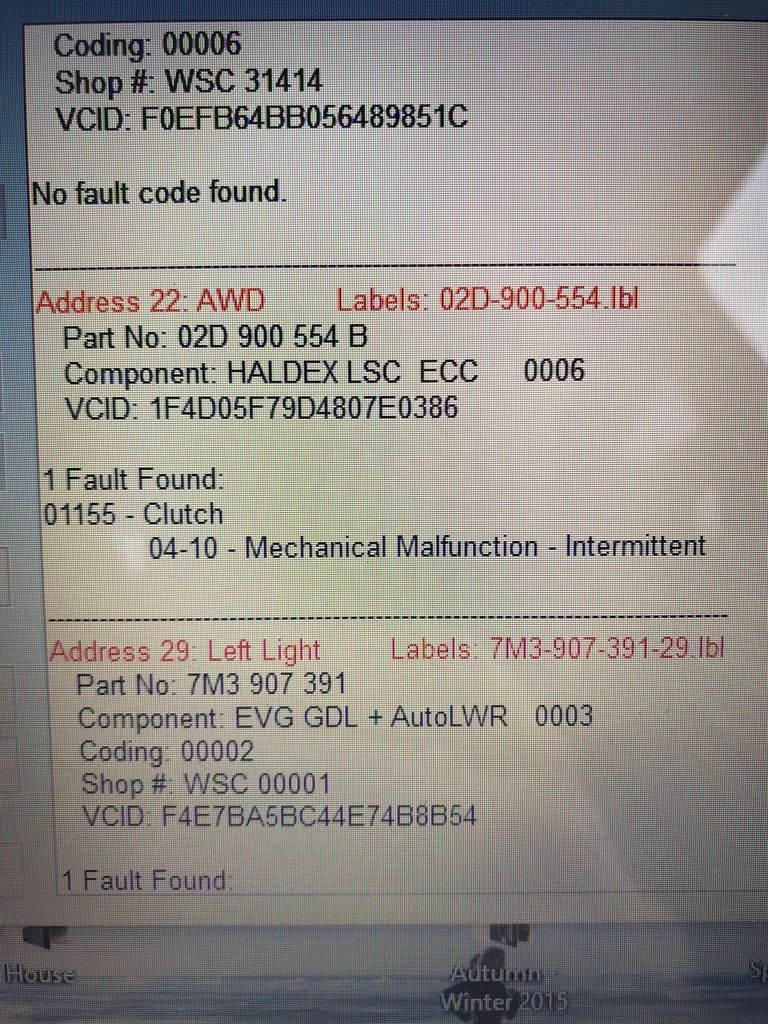

Then day after driving it back from Luton I headed down to Leeds to see some mates, leaving Leeds the car decided it wanted to be FWD  :rolleyes:
Got it home and scanned it:
Balls  :undecided:
On a more positive note, the only other fault codes were relating to the headlights (which I think just need aligning), and the aerial.
Anyway, I did an output test on the Haldex pump and it showed me that the pump was dead. I was planing on changing the Haldex oil/filter anyway so ordered the parts for that and bought a working 2nd hand pump to see if the pump was the culprit.
I got the car up on a lift earlier and swapped the pump over...Haldex is now working, thankfully a nice easy, (cheap) fix. I will sort a new pump in a few weeks as I have no idea how many miles the pump had on before i fitted it.

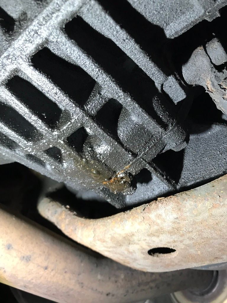

The diff was covered in oil though which is slightly concerning:
However, when undoing the drain plug on the Haldex it was apparent that no seal was fitted the last time the Haldex oil was changed :shocked:
I am hoping that the oil on the diff has actually leaked from the Haldex and ran backwards while the car was moving. I've cleaned it all up and will keep an eye on it.

Timing chains look fun :(
