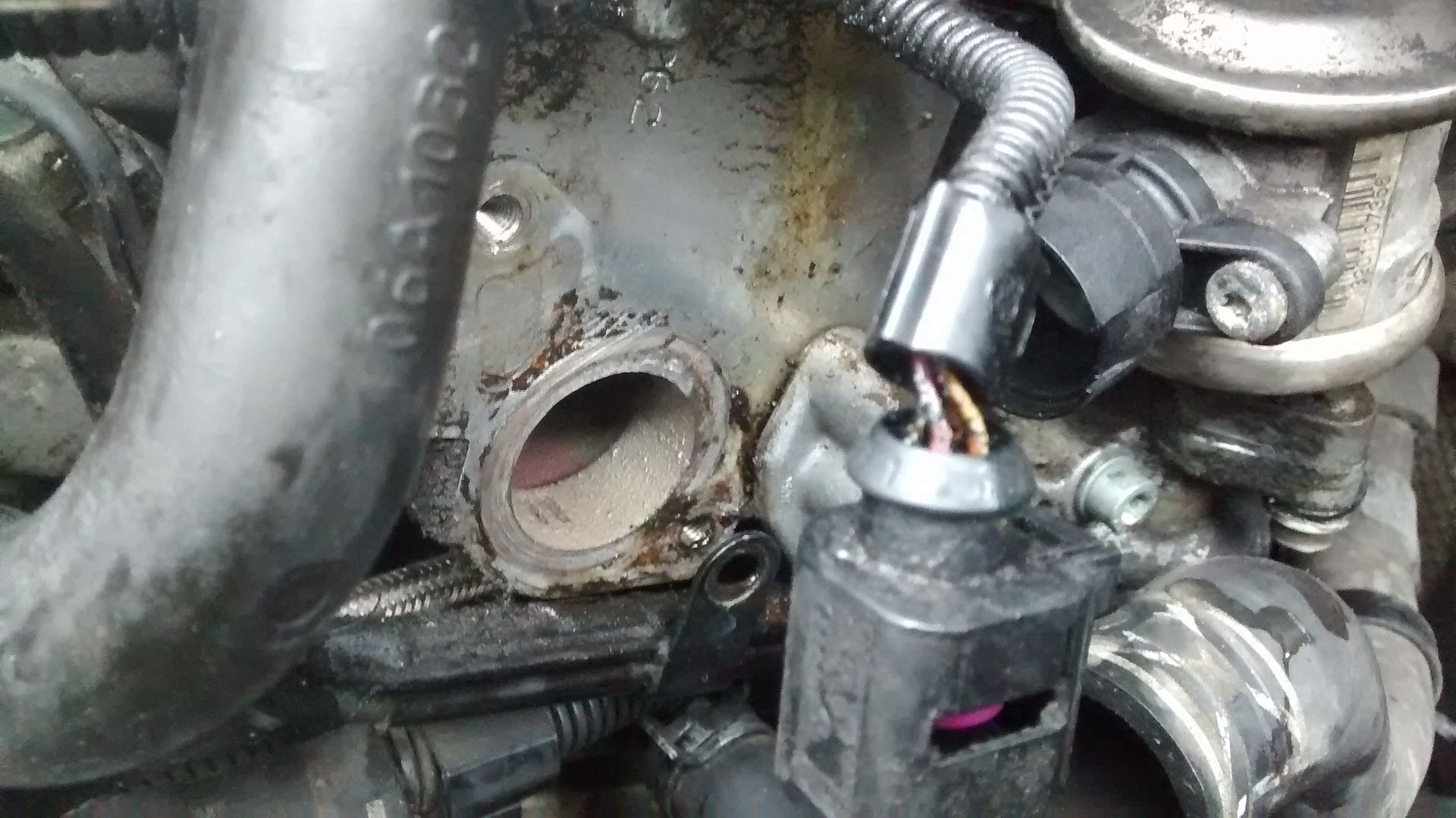

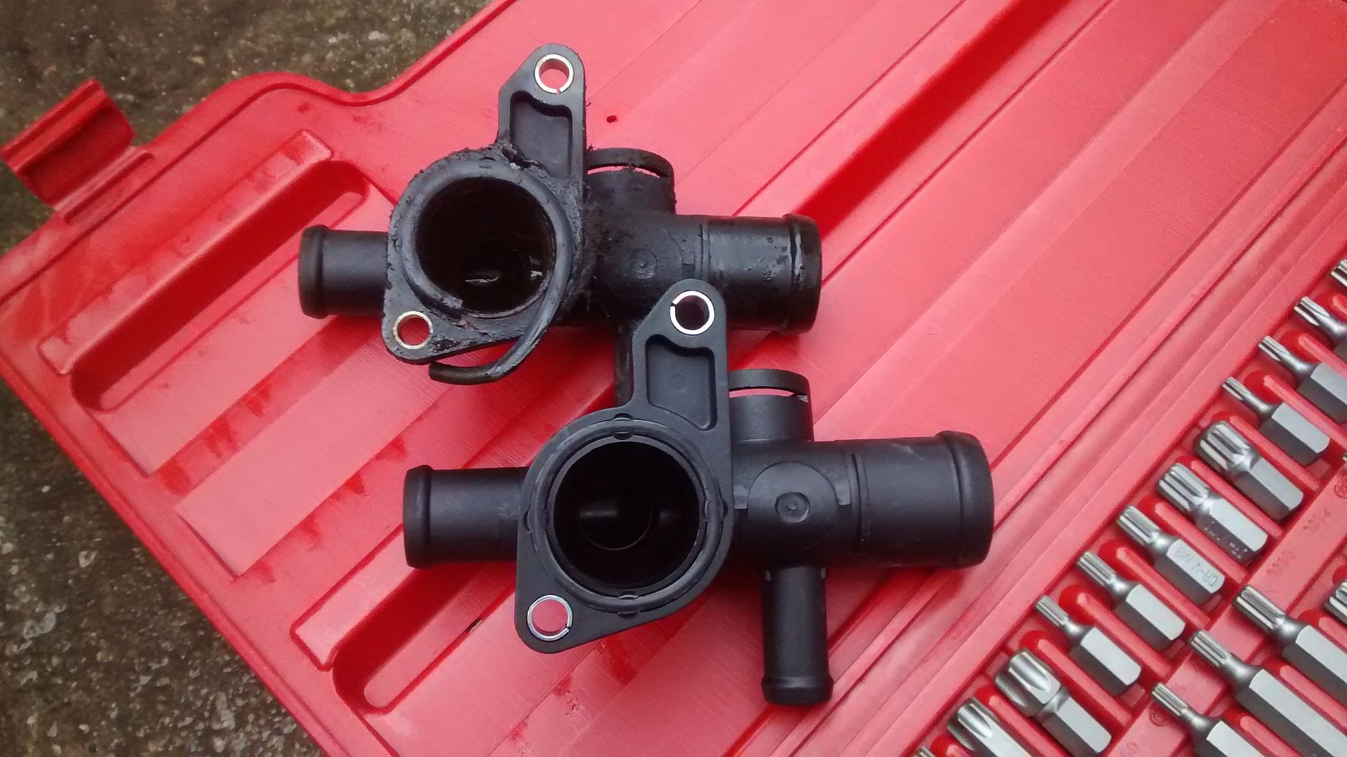

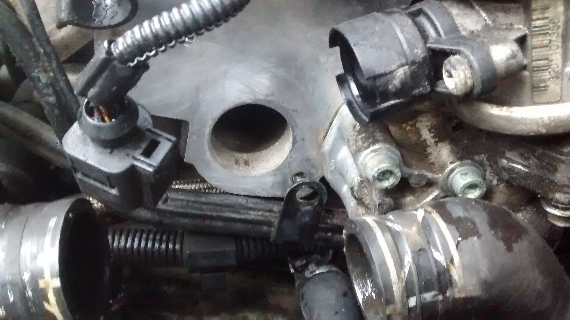

here is the old flange and the block.
What I noticed, is that the coolant went down quite alot after running it, I am hoping its just bleeding itself of air and dropping as a result. The header hissed when I opened it so theres clearly pressure in the system.

The way that block looks you wouldn't have needed any additional sealant me thinks >D
2019 Seat Leon ST FR DSG 135kW - eclipse orange - 23k miles
Offline Wazzzer
  • Moderator
  • Posts: 11,172
  • Golf GTI 1.8T AGU
Re: torque settings
« Reply #6 on: 13 December 2015, 18:52 »
Now that's proper clean...

I spoke to one of the mechanics next door who replaced 2 of these in the space of around 6 months and suggested a little RTV to be sure.
I think its a poor design really, surely a stainless flange would have been better? Even TPS have these flying off the shelf which I would have thought VW would have re-issued a more sturdy design?
Oh well, its in the hands of the gods as to if it holds out
 :smiley:
