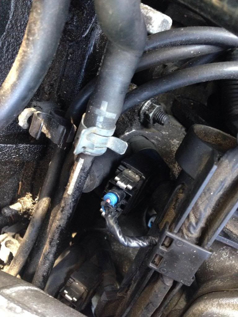

Here are some photos, In this photo: http://i1372.photobucket.com/albums/ag332/jamieisafish/Mobile%20Uploads/image_zps9dd30ce2.jpg
you can just about see the fuel in the electrical connector.

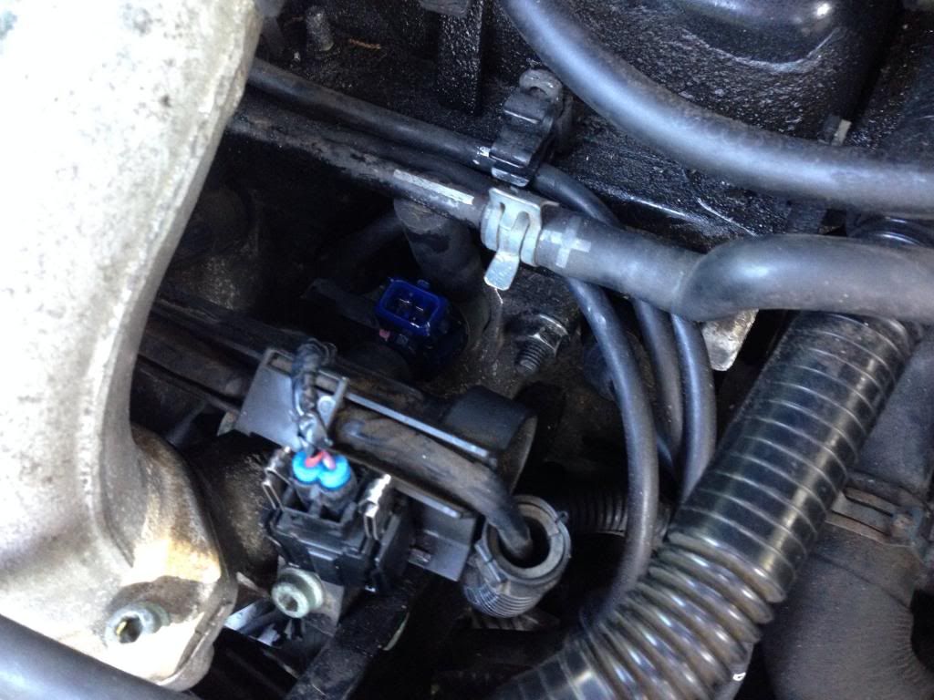

This photo isn't great but again it's of cylinder 4 where the misfire is: http://i1372.photobucket.com/albums/ag332/jamieisafish/Mobile%20Uploads/image_zps886d854a.jpg
Cylinder 1 also has fuel in the connector as well. The injectors aren't leaking from anywhere else
