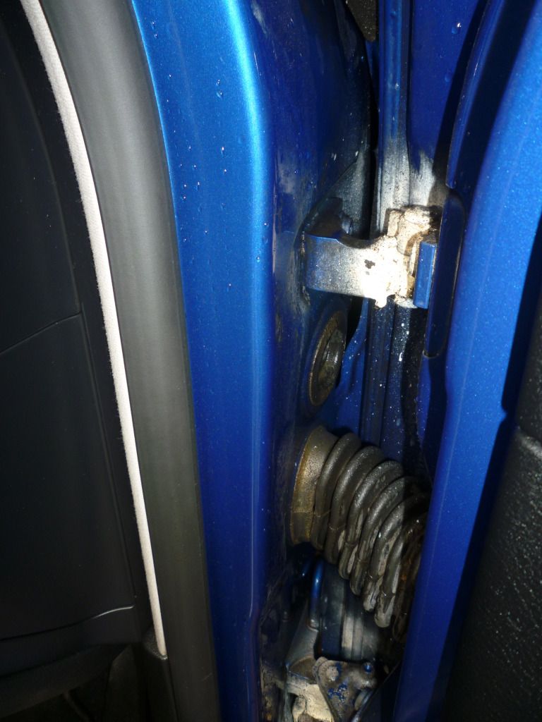

Offline Steve_PD
  • Posts: 7,121
Re: Rear mats damp
« Reply #6 on: 24 June 2012, 21:14 »
Nipple is just below the top hinge. Every mk4 has them.
Looks like this
Offline dstv
  • Posts: 108
Re: Rear mats damp
« Reply #7 on: 25 June 2012, 18:01 »
i dpont have that on mine. just the black bung ???

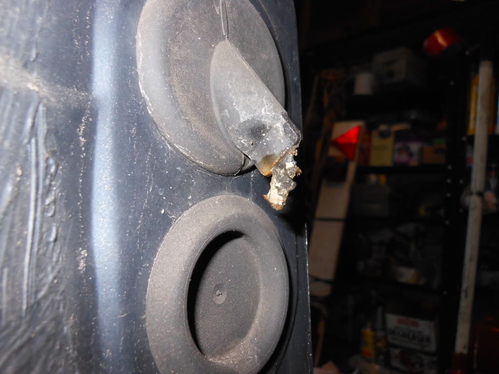

Offline on-the-rampage
  • Posts: 123
Re: Rear mats damp
« Reply #8 on: 28 June 2012, 21:02 »
heres what mines like
