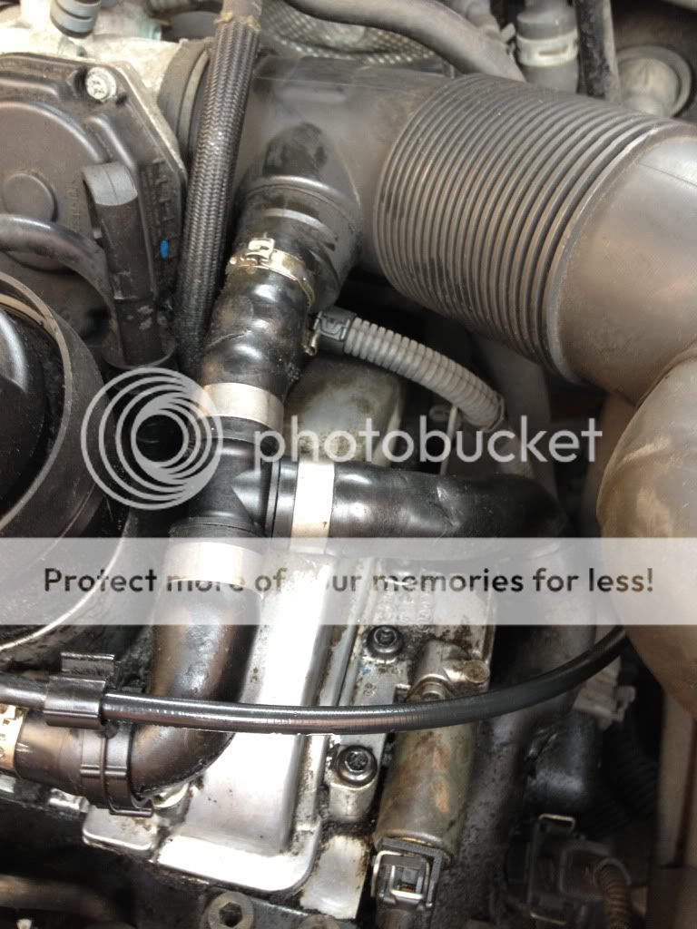

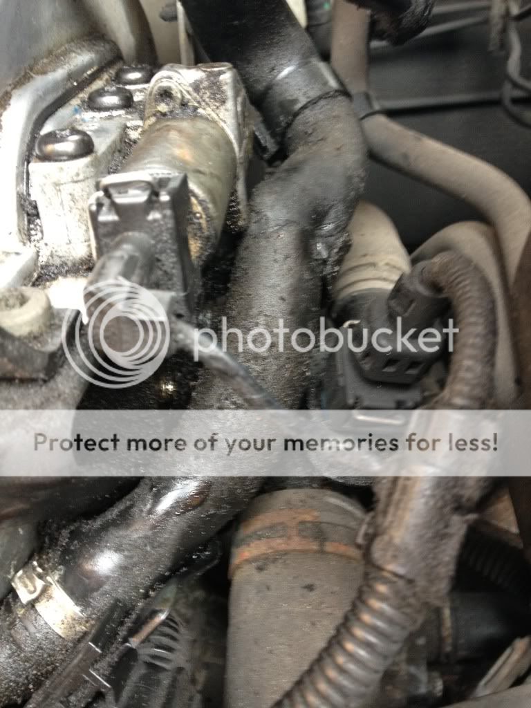

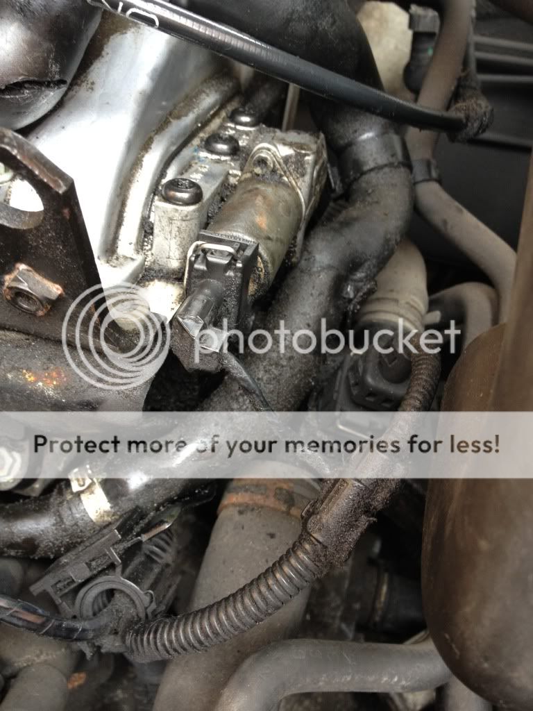

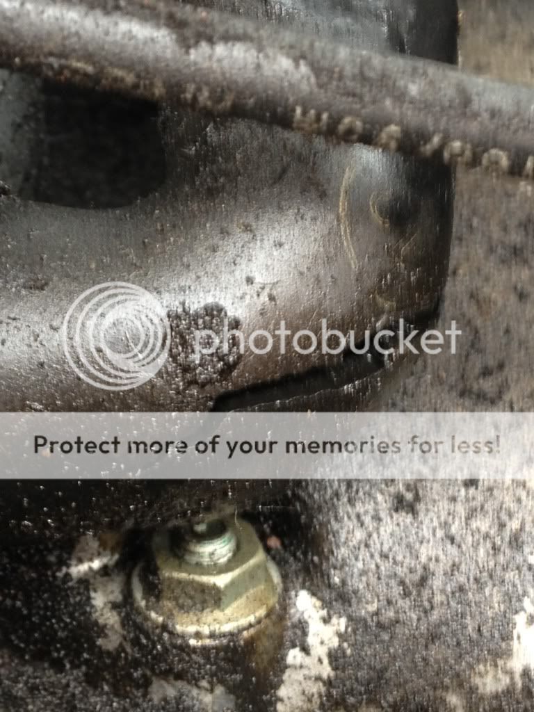

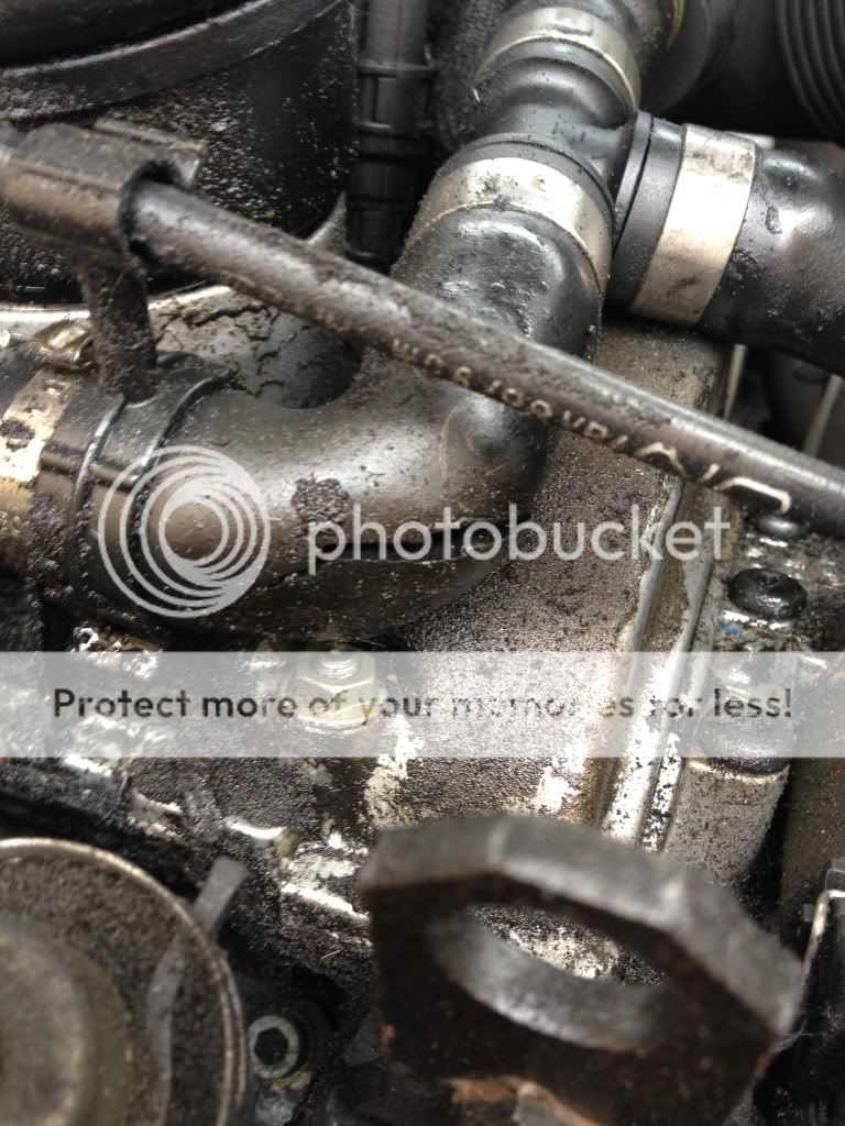

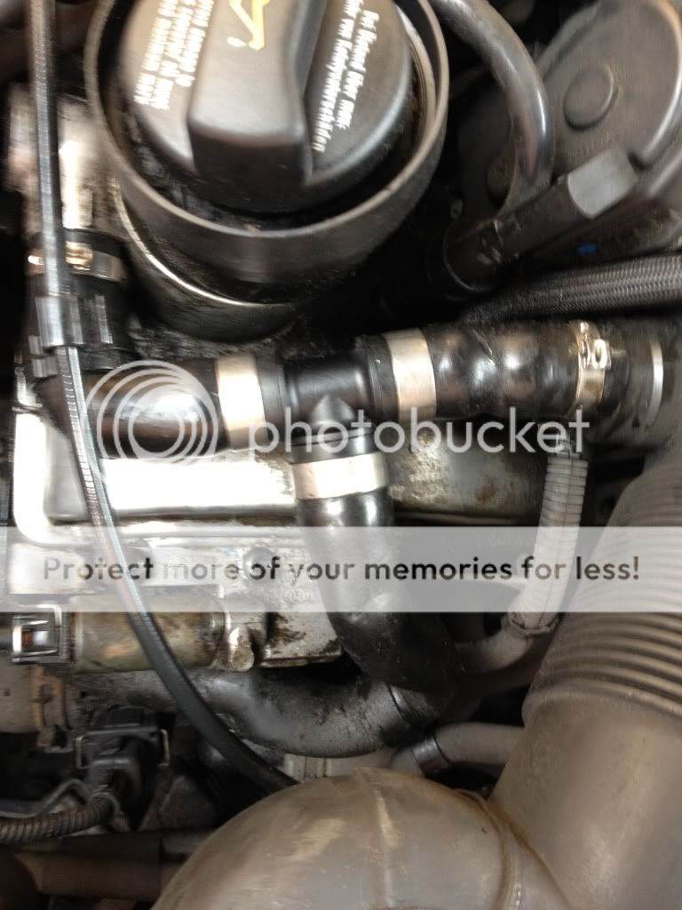

Hi guys. I found the source of the smell. It was 3 absoultley shagged out breather pipes full of holes and perishments. You could actually stick you finger right the way through some of them. I will upload some pics in a minute. Thanks for the advive :)

Offline DunnDeal12
  • Limited
  • Posts: 704
Re: Smell of Petrol
« Reply #6 on: 28 June 2012, 18:48 »
think you engine bay needs a clean :lipsrsealed:
Offline thfc_123
  • Posts: 84
Re: Smell of Petrol
« Reply #7 on: 28 June 2012, 19:06 »
I done it before putting the new pipes on ;)
