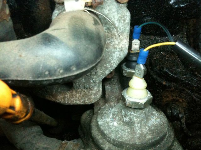

Didn't want to start a new thread, but i've searched all night and cant find my answer. So i though i'd dig this one up.
Im having trouble with my oil pressure switch on my 16v. Reading RJ post about blue/brown and white makes me wonder if i have to wrong switch fitted. Heres a picture....
Ive found a brand new blue switch with loads of stuff that came with the car. Should i change the black one with the new blue one?
Any help appreciated

Yep.  :smiley:

Yep.  :smiley:
Is the black one wrong then? Cheers
