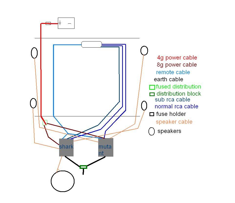

this is my plans for seting up my music system does this look right? and is there anything else i could put in to improve it?
cheers Deano

Will depend what bits you use. I would say however, dont bother with rear speakers. They only drag the centre of the sound back ie the bit in the car that sounds best will be just behind your seat and who sits there?
Save some pennies and buy a decent 4 channel amp and do the fronts and sub off that! will mean what you but will be better quality and sound better too, you win!

yup....ditch the rears mate! :evil:
