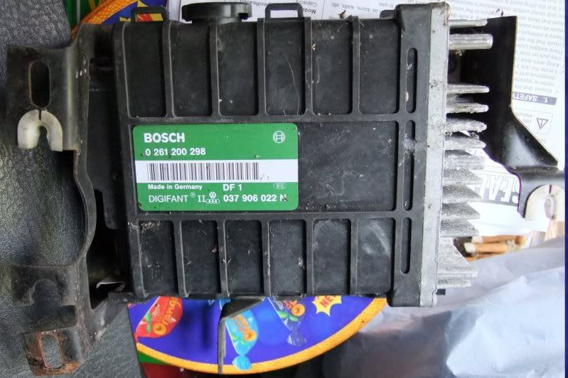

Having said that the 037-906-022 N model I have matches the Bosch Part Number, but not the VW one.... :huh:

Managed to borrow an ECU, same as the one photographed above from someone locally (I have to replace it)
Fuel pump primes and then stops which is now right but the idle control valve is running constantly, is that normal?
Car still won't start, got the plugs out at the moment as its damp in there...
Don't seem to have a very good spark, anyone got any suggestions?

Wasn't getting a spark so started checking other stuff, turns out that the ignition module on the ecu bracket on the ecu I borrowed was no good, put the original one back on and it started straight away.
Just need to do an oil and filter change as the oil smells a bit of petrol after the original ecu failed and completely flooded the engine.
