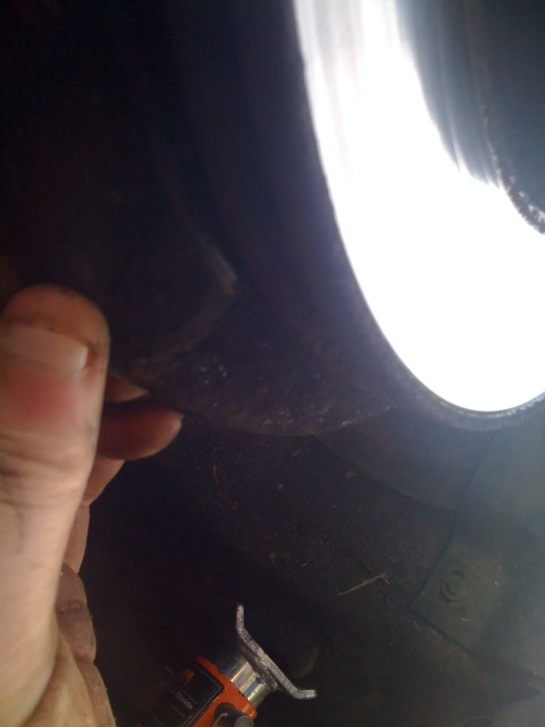

My N/S dust shield is loose, it's got a shiny groove from where it's been making contact with the disc!

 :undecided: Mine's wobbly as f**k, quite a bit of play and I couldn't see where it was attatched to see if I could tighten it.
Here's a few pics, 1st one is a close up, 2nd is a bit further back to see the groove in relation to disc (was a sunny day  :cool: )
