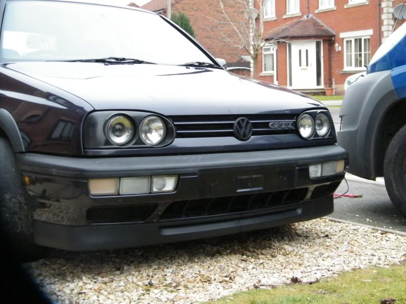

Cheers jv  :smiley:

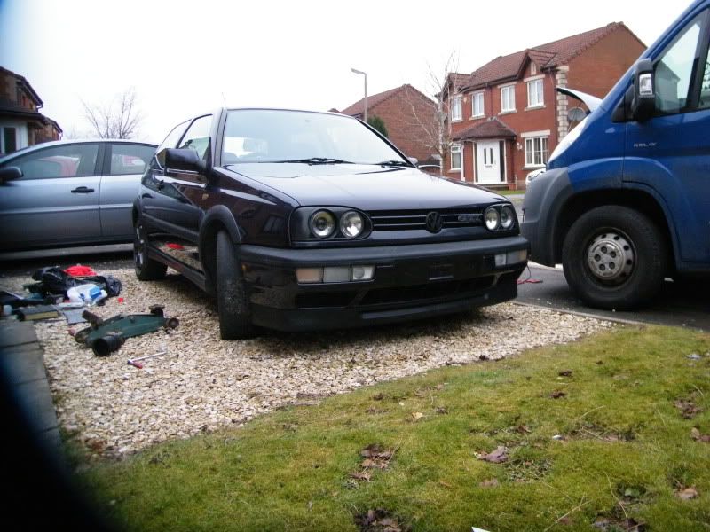

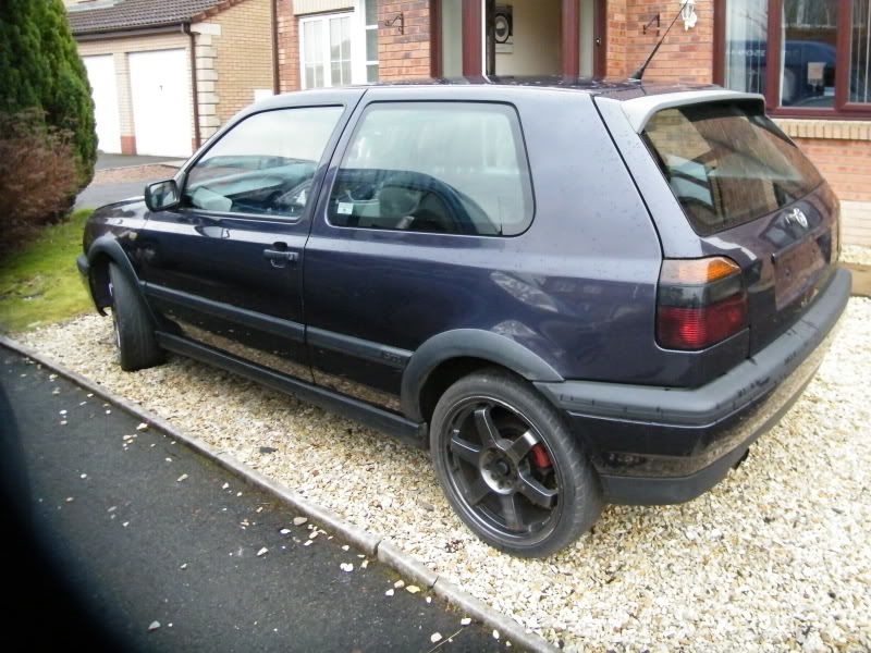

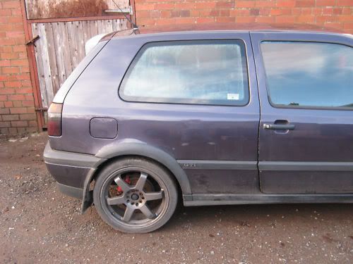

I was looking for a mk3 gti non runner on ebay to start a wee project and was bidding on a red N reg when i came across this 97 P with 113k in twilight violet with electrical probs local to me, infact the owner stays 6 doors down the street. So i went to see it and what was wrong with. £250 quid later and a tow home it was mine.

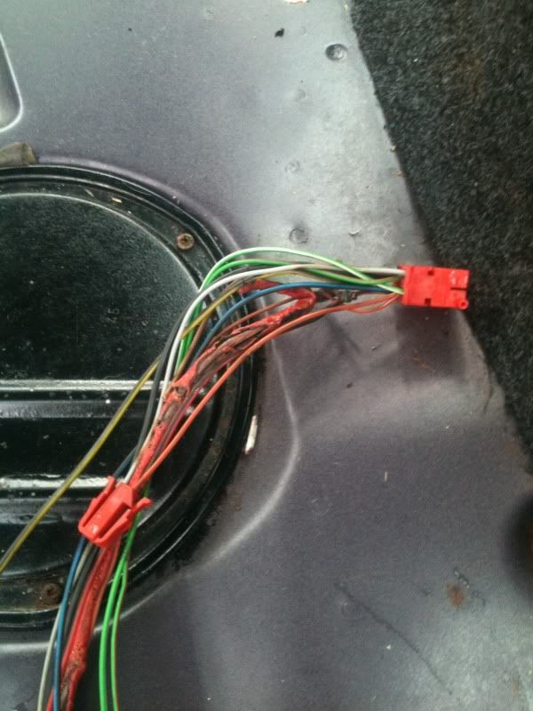

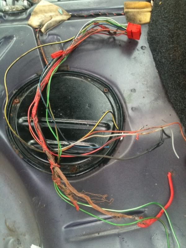

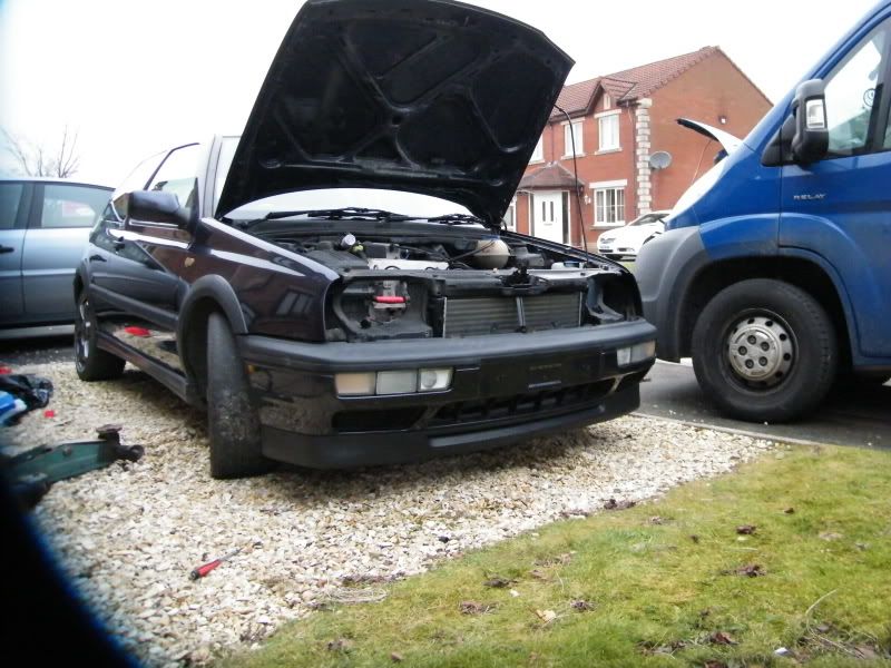

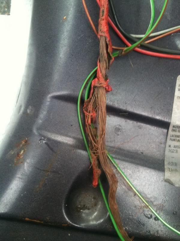

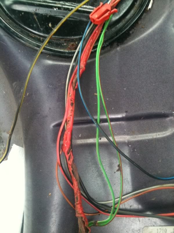

Once home i had a good look at the damage and what was needed. First thing was the wiring loom from the ignition to the fuse box. The previous owner was having problems with the car cutting out and eventually not starting, so he started ripping the aftermarket immobiliser out and ended up doing this
So a trip to the local breaker and by luck had just taken delivery of a green gti 8v. Striped the loom out and fitted it to mine connected the battery jump leads on key in and nothing!
quick test and ignition switch is goosed. (did wonder why it had a push button start)

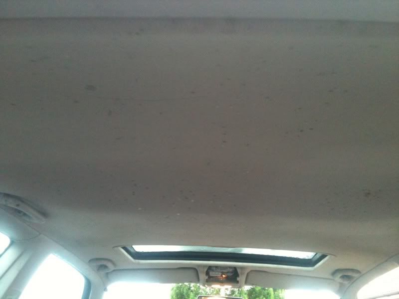

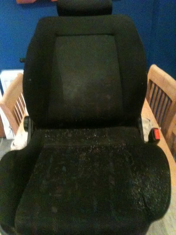

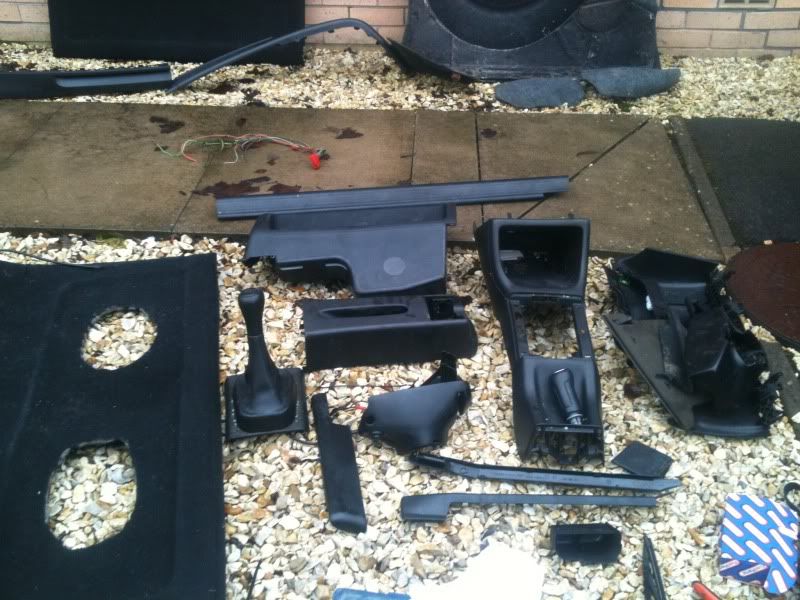

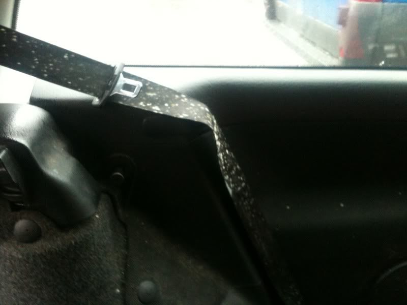

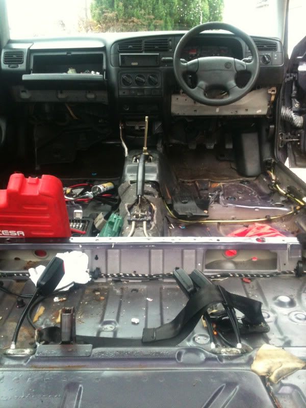

while waiting for this i decided to strip the car out completely as it was soaking and mouldy inside with all the snow we had and the common mk3 leak points.
All cleaned up

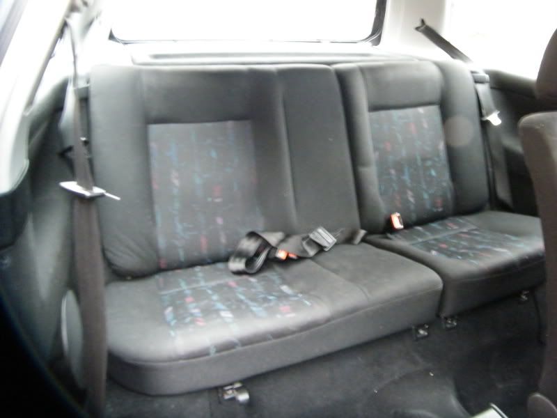

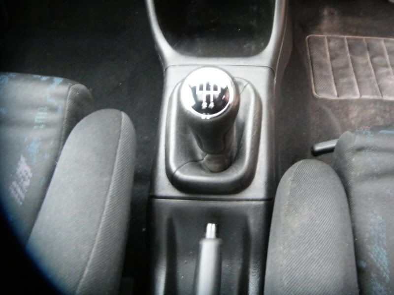

Next job was the interior rebuild which i wasnt looking forward to. I got a new headling as the mould wouldnt come off and also some less saturated sound deadning for under the carpet. 4 hours it took which i thought was not bad at all  :smiley:

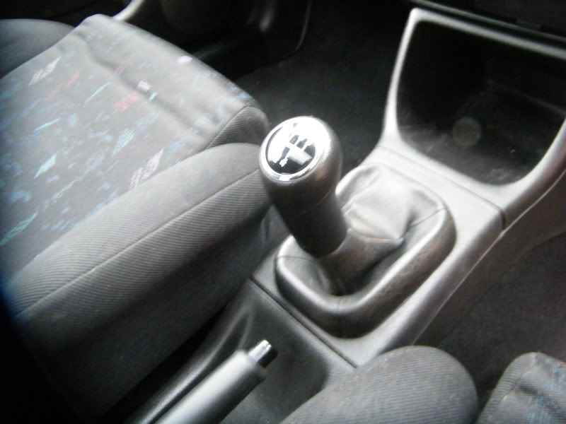

Polo gear Knob

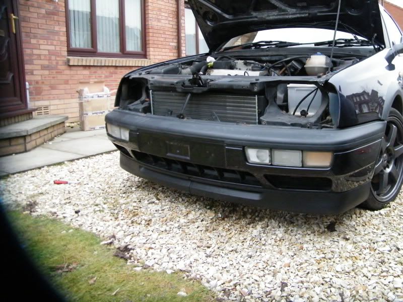

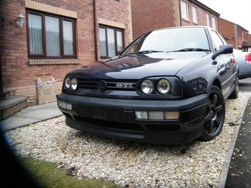

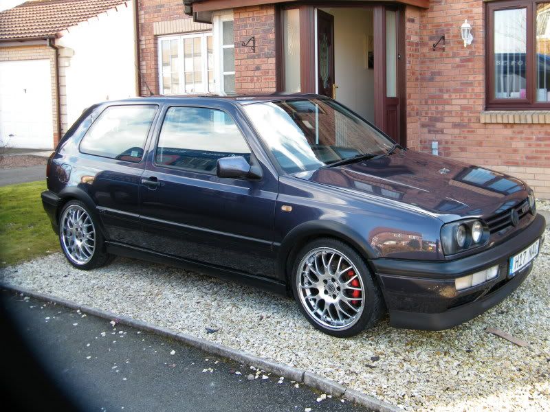

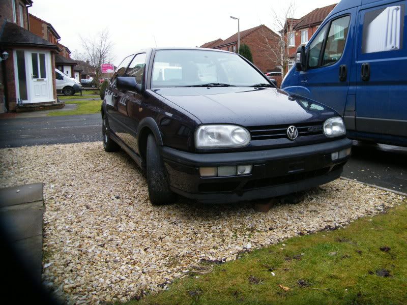

First mods was the hella twins, black badge and VR6 chin. Looks a lot better me thinks :smiley:

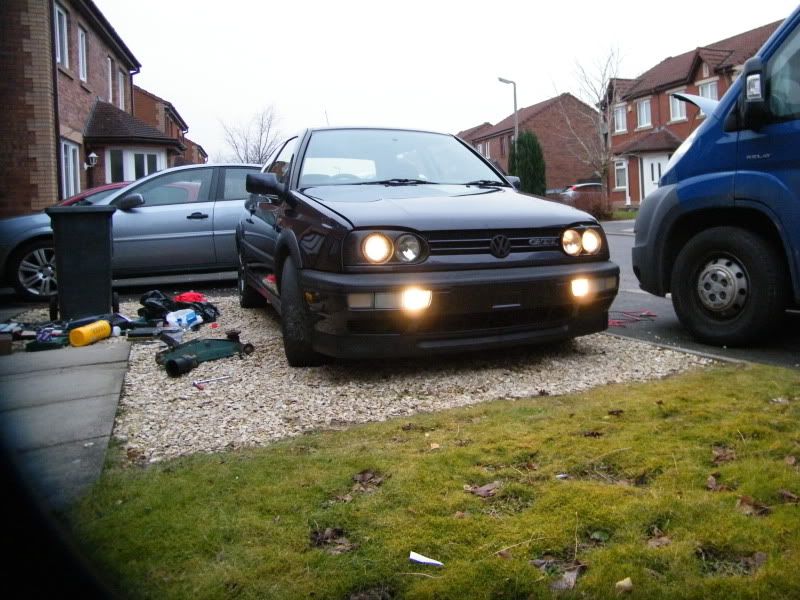

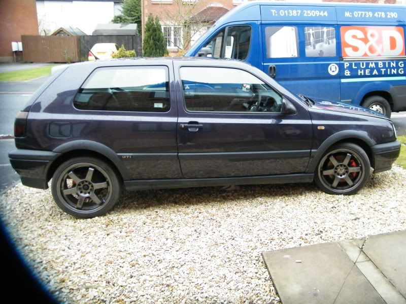

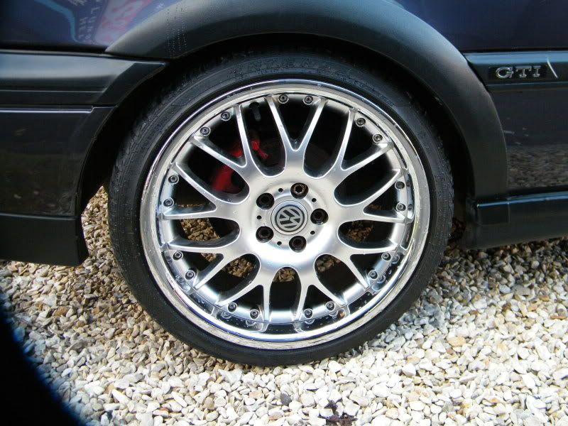

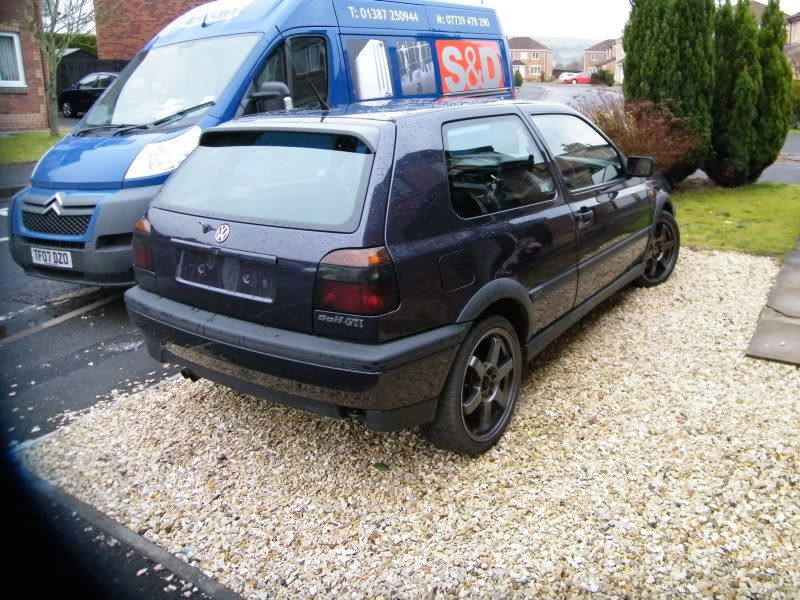

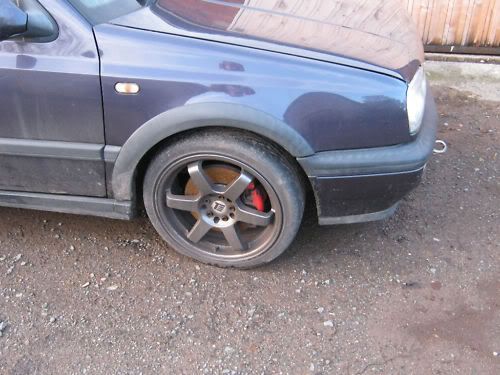

Next on the cards had to be the ride height  :huh: Ive went for 60mm front 50mm rear springs at the moment as im not sure about cheap coilovers and didnt want to splash out on expensive ones not to like them. but i quite like the height and might just uprate the shocks and keep them as i have a lot of speed bumps round my scheme and it clears nicely and is quite comfortable as is. Fitted my number plates too, i know there not legal but i'll see how long i can get away with them  :smiley:
Also found a little treasure from the guy next door in the form of 17" wheels which i will be purchasing from him next week as i like them a lot  :smiley: :smiley:
