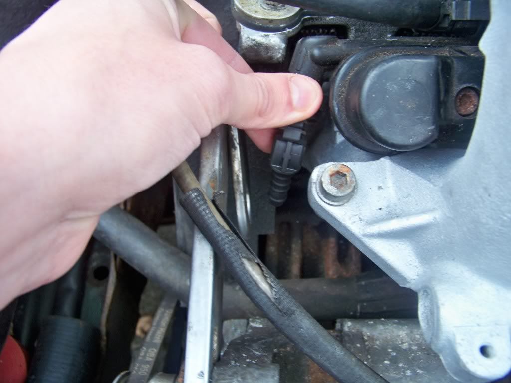

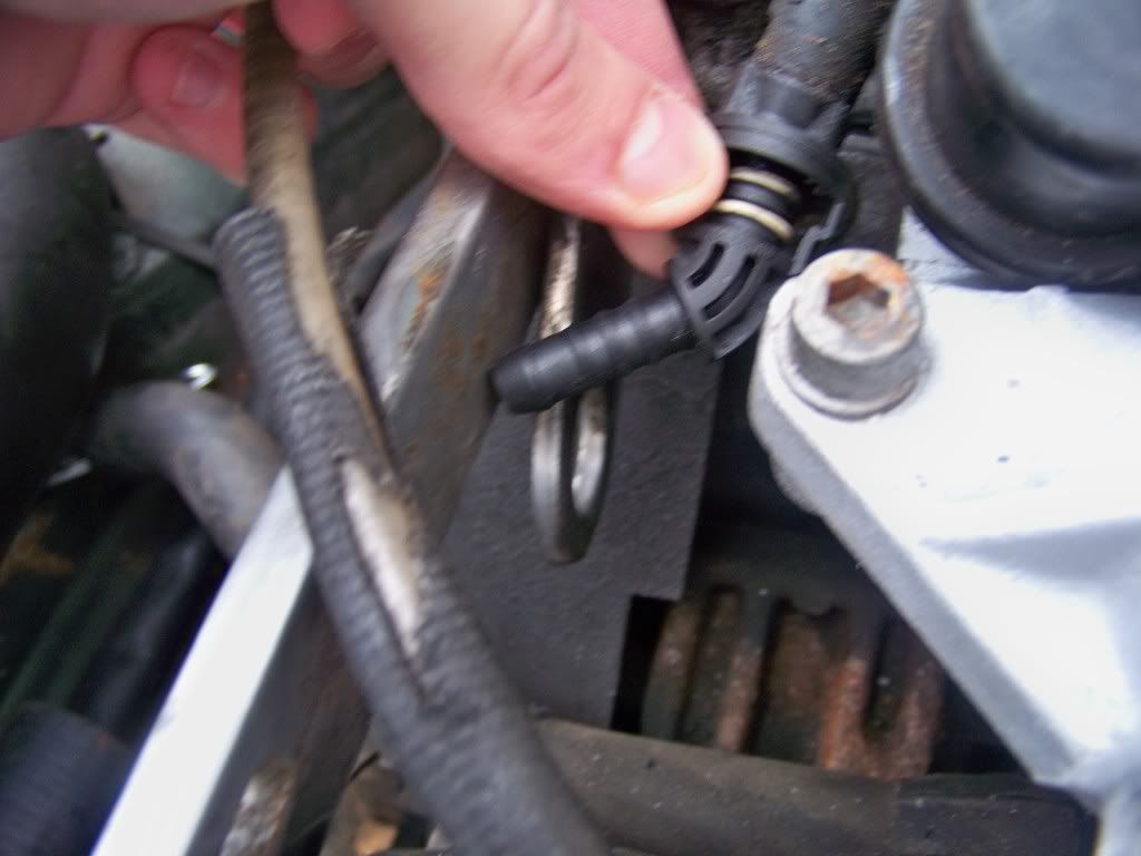

cut a slit in the rubber/plastic where ive highlighted in red, then remove them. you are then left with a barbed fitting, prefect to push on your abf lines, just make sure you buy proper fuel line clips to secure them.
unfortunately your abf fuel lines have been cut short so they may not reach, if i was you i would try to source some uncut lines as they'll reach perfectly.
this is exactly how i did my own abf swap and its been driving for almost a year with no leaks :)
however i am planning to change to mk3 fuel tank and lines in the future though as its a neater solution, just the 1 pump in the tank so no more corrosion issues, plus easier to get them from zee scrappy
« Last Edit: 24 January 2011, 09:54 by rubjonny »

Thats a simpler option, thanks!. another boy told me to cut off those fittings then get some sleeves so I can put my abf lines over them and tighten up.
Yer I just wants the thing to start so not too fussed on the mk3 gear, if I keep it, then next winter Ill do it.

The flow elbow is too close to the a. the alternator bracket ( 9a engine) then b. the manifold if flipped around. So I cannot get my hose on without it kinked, well I cant even get the elbow in yet either but that will prob just take some wriggling.
Is the Abf alternator bracket designed to allow for the flow fuel line. It would be fine If I could get a 90 degree elbow for it, but the abf ones are 45 degree's.
As it is now, obvious what the problem is
And would work like this , but the clip bits are 90 degrees out
