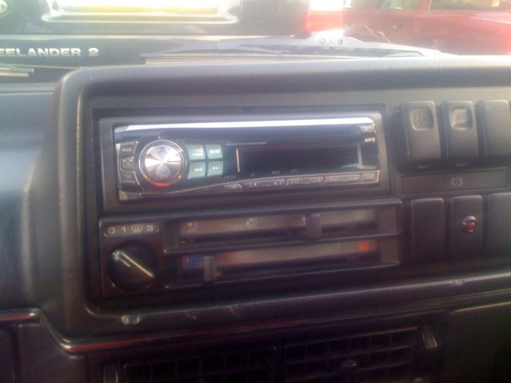

My Golf current has an Alpine head unit which I think will be fine?
http://i154.photobucket.com/albums/s246/nickfowke/cfb51e59.jpg
