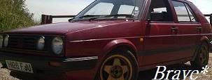

I have a 1.3 mk2 '91,
I am doing a KR conversion,
this will be a post followed up with many more questions i would have thought,
but the one going through my mind atm,
is im doing this conversion (wiring wise) very minimalistic,
because i dont really understand injection, or wiring for that matter,
my question is, could i use my current loom for stuff like, starter motor, gearbox reverse light, dizzie earths, those sort of things,
and then thread another loom for the things the carb engine doesnt have?
