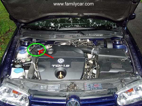

sorry i sound so dim, no its the one on the other side, a small 90degree pipe on the drivers side of the engine
Offline martin_jg
  • Posts: 64
Re: induction turbo hose
« Reply #4 on: 08 April 2010, 09:39 »
this one here:
Offline Rhyso
  • Posts: 26,687
« Reply #5 on: 08 April 2010, 09:42 »
EGR to Intercooler pipe
