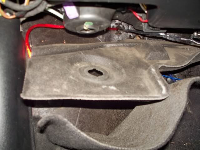

couple of pics that might help  :undecided:
passenger side under glove box
passenger side trim to run cable
