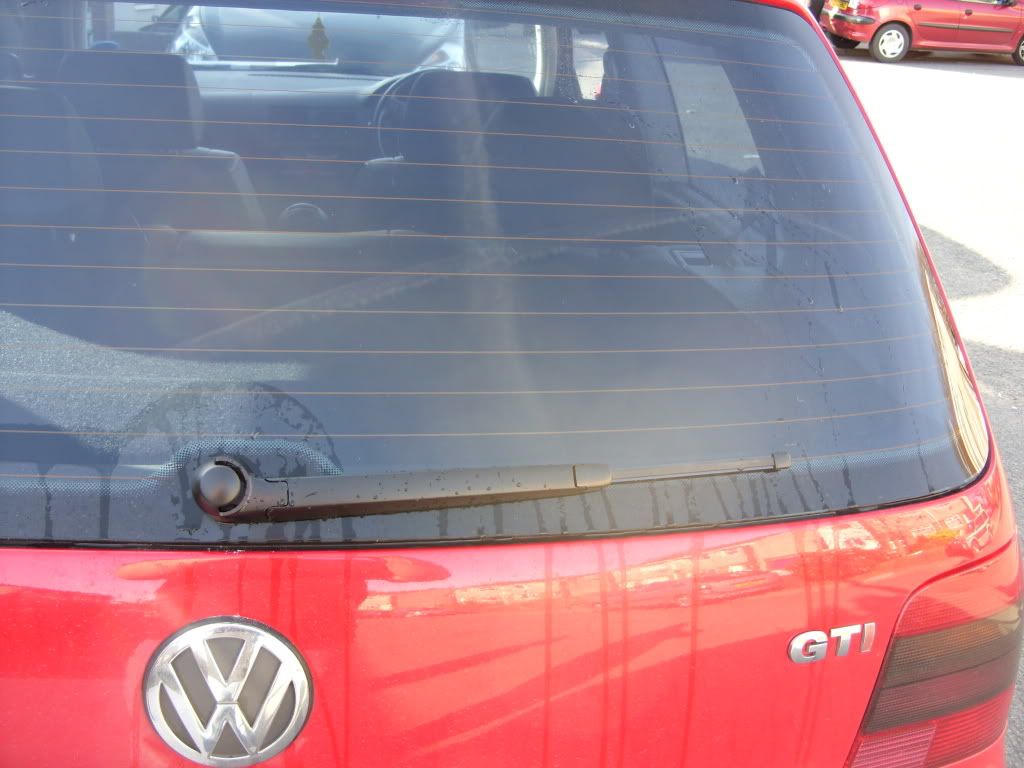

And a mk V Rear aero wiper
Before:
After:
