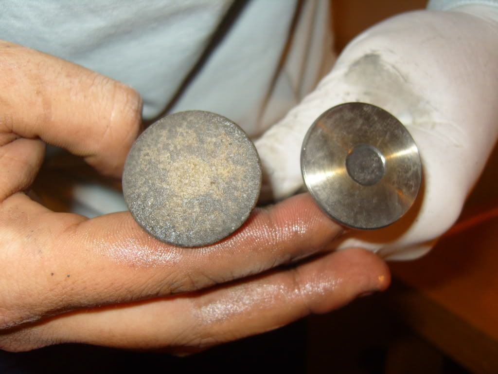

as long as youve not damaged/took chunks out of the valve i would have thought youd be ok
tahts alright then, its jstu very lighty scratched and i havent deformed it or anything :smiley:

clean the carbon with a wire brush , try to get all of it off as gently as pos but use a little bit of force (i think it's known as engineers feel ) :laugh: if not in my cause hot spot's in burn the valve out early ,
i've done a few (working for landrover we take heads off K series in our sleep  :shocked:)
and USE A TORQUE WRENCH  :wink: :wink:

today is a crap day, so im gonna wait for a good day to come along (probably august 09 :grin:) so i can wash the head with pressure washer.
valves i'l probably get working on them this evening at some point. cheers dudes.

also if your gonna try clean the head try getting some of that wheel acid cleaner from a garage / valeter :) will come up a treat  :wink: :wink:

quick update.
polished the valves this evening. came up a treat :smiley:
