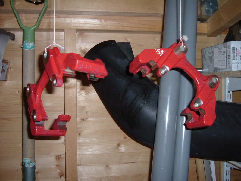

The carriers recieving the first coat of red paint...

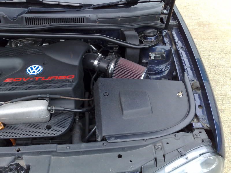

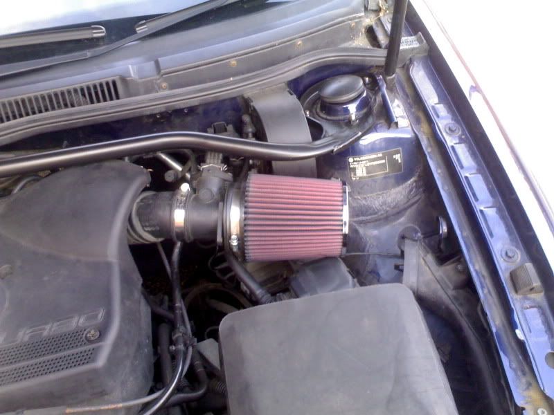

and I ditched my CAI as I was so paranoid about sucking a puddle up and ruining my engine so I fitted this K&N instead (and no I haven't had any MAF problems since!)

and got hold of some spare calipers to paint red to match the carriers
mmmm gold  :sick:
the sliders and guides were also painted gold so these went in the nearest bin
to be replaced with brand new items
and after an hour of paint stripping and wire brushing, we have a caliper that's ready to paint

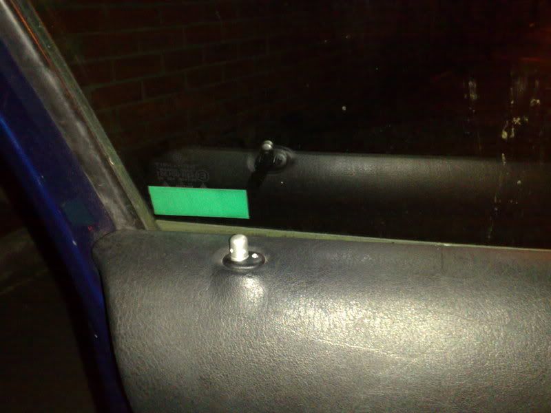

and I fitted my Beetle Sport door pins (you can just about see the Octavia wheel in there)

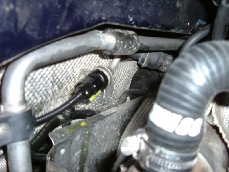

and a dodgy A/C pressure sensor that p!ssed all my newly acquired fluid everywhere...
and the new one fitted

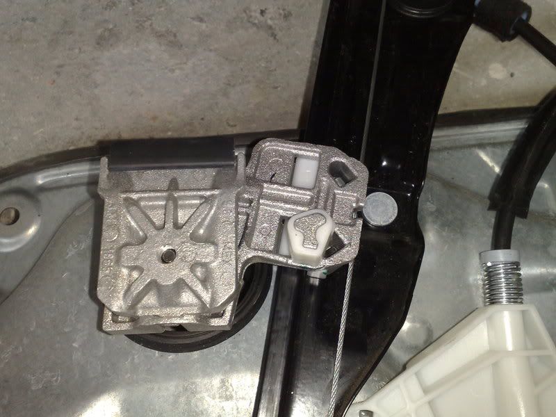

They had the great idea of using 2 piece metal/plastic clasps to hold the door windows in while they were positioned on the runners. The cable system used is very good and smooth, but unfortunately too powerful for the plastic clasps to cope with and ultimately, they break.
Now you can be lucky and catch it before your window disappears into your door. I wasn't so lucky.
My passenger window spent most of Tuesday sat in the bottom of the door waiting to be fished out.
When I got the door card and the metal backing plate for the window mechanism off, I found one of the clips freshly broken but the other looks like it had been sat there for some time
I had to move the car into the workshop where I work temporarily to make sure it was nice and secure as a bit of tape was the only thing holding my window up now
now I had the plate off I could start removing the old winder and the knackered cables with it
The cables had fouled on each other and bent
A repair kit was ordered from the dealers which comes with 1 piece metal clasps and a new winder which were firtted on to the plate
A close up of the new clasps and the superior design
and where all the old stuff ended up...

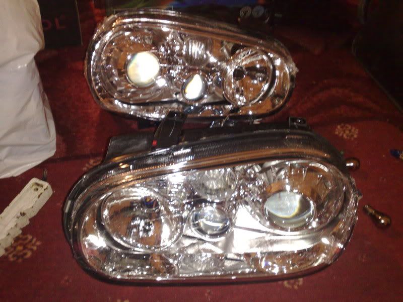

here's a few pics of what I've been up to with the lights
as they were out of the box
A pic of an anniversary light and projector to show what I'm trying to achieve
I've managed to split the lamp apart and get the surround out ready to paint
I've fitted my HID back into it now and all the bulbs are in too. I'm resealing the lights with some bodykit adhesive I bought to refit my anni sideskirts, it should do the trick
