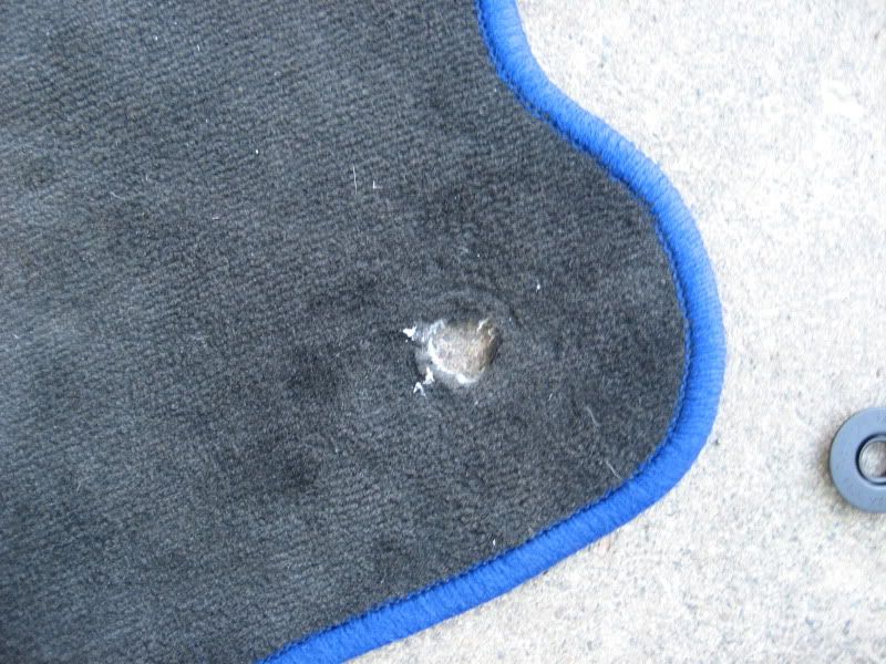

Fit the push fittings to my rear mats (been bugging me for nearly 4 years  :laugh:)

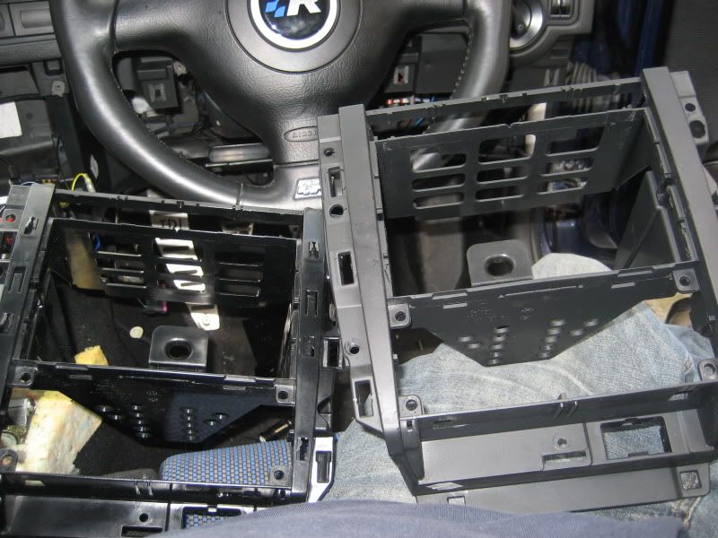

And here's an idea of what needs to be removed if you have a standard radio cage like me lol
Before
During
Reason why:
Afters:
