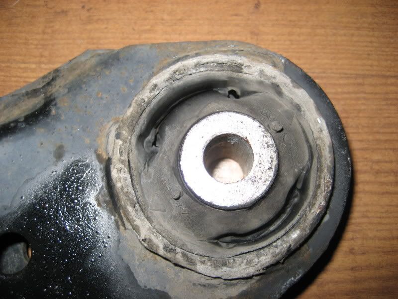

new wishbones complete with Audi TT bushes have been fitted by Alan in work :afro:
here's a couple of pics of my old ones!
got to get the tracking done but first impressions are ok but i haven't really thrown the car about and i won't until i know both wheels are pointing in the same direction  :grin:

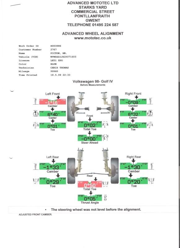

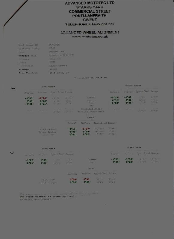

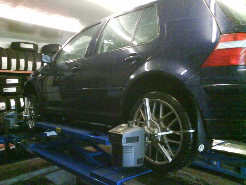

so today i had proper 4 wheel alignment carried out at Mototec in Blackwood near where i live
here's the results
as you can see the camber was out but not as much as i was expecting
a quick adjustment and this is what i've now got
and they did a chassis alignment - looks straight to me  :grin: :grin:
Picture of the car on the ramps
First impressions are good; despite it being only a small adjustment it does seem better planted at speed like it used to be.  Most of this could well be a placebo effect but as long as its a positive one i dont really mind  :smiley:
and also my steering wheel now sits perfectly straight  :smug: :grin: :grin:
IMO well worth the £43 it cost me and after any further suspension work i'll definitely be heading back to Mototec :afro:
