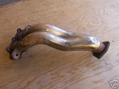

Hello chaps - tis continues to rattle like a git between 2750 and 3250 rpm in all gears.
Have had a go at heat wrapping, exhaust gum and attempting to dremel the heat shield bit off - all to no avail.
So what's its official name and what price a replacement?
Whoops can't work out how to include an image...I'll be back

Replying to myself - I do this quite often.
Anyway, still a bit confused about the method of pasting an image into a message
well thanks for looking and any help would be appreciated. Now if only I could work out how to pm on this forum...

Its your downpipe
exhaust pipe / for models with catalyst / F 1H-R-000 001>>
front / 2E
Part number - 1H1253091
Its arround £180 from the deeler.

Personaly i cant see how the downpipe would rattle, you sure its not the heat shield that covers the manifold at the top? they tend to rust off,  its the one where the hor ait feed joins to go to the air box.

I would think it was the heat shield, but not sure where yet. If you have the bonet open and rev the car it doesnt always happen. Happens more once you get moving. I will have a look later though to see what i can see while the car is cold

HACK IT OFF!! no need for a whole new one for that  :grin: :grin:
