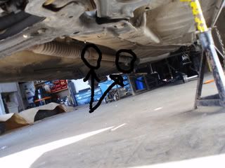

After getting anoyyed with a few exhaust holes in my 1.3 (sounds like a v8) i was wondering if it'd be possible to fit a gti exhaust off either an 8 or 16v? i know that they are slightly different in design but are the bores majorly different? Its just that almost complete used jobs go for pennies on the bay. its gone at the joining sections but its rusted into some nice holes!
i'm not too bothered about the having a cat but how could i go about it?
cheers
Chris
ps anyone spotted the floating left side  :laugh: woops!
