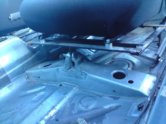

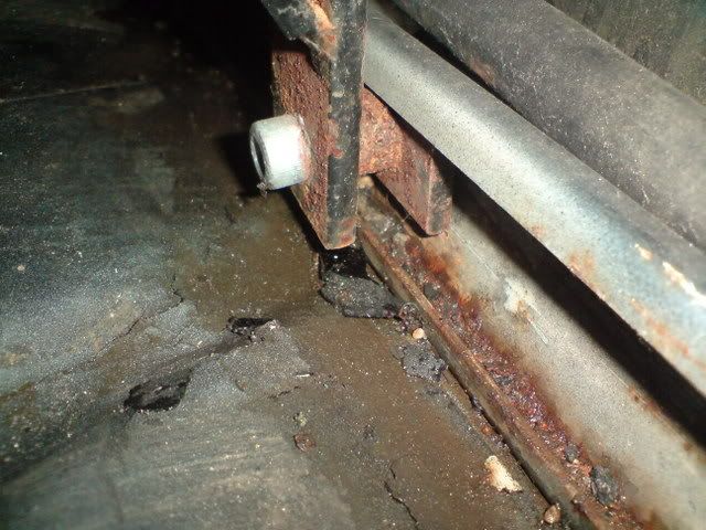

« Reply #5 on: 13 April 2008, 12:12 »
having just looked at my subframes it seems i know sod all about my own car!
the seats have runners bolted directly to them and a subframe is bolted to the runners.  the subframe is made to locate in the standard mounting places and its made out of bar, not box!
this is how it is attached into the runners.

they were made for the previous owner as custom jobbies. looking at the way they attach they should fit mk 1 and 2.
if i had to fit buckets from scratch i'd follow dan's route mentioned above
