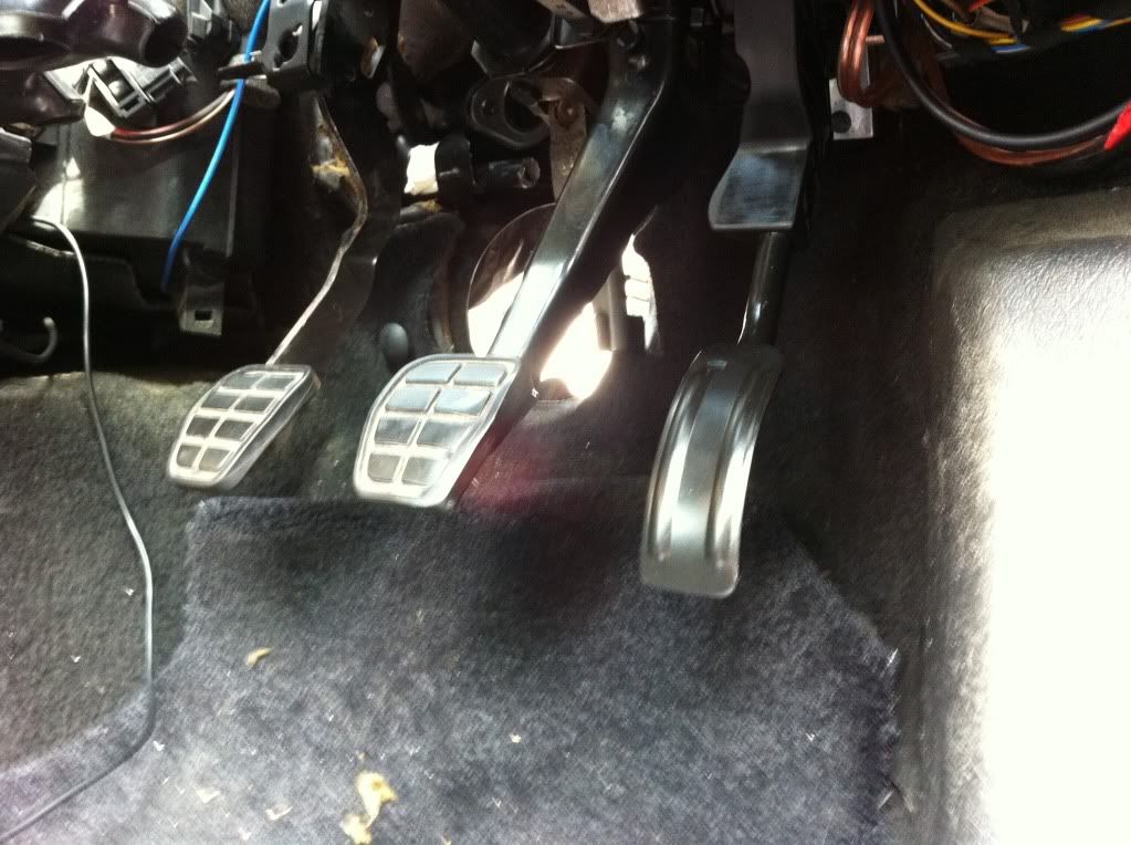

Update.....

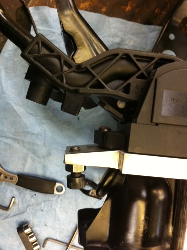

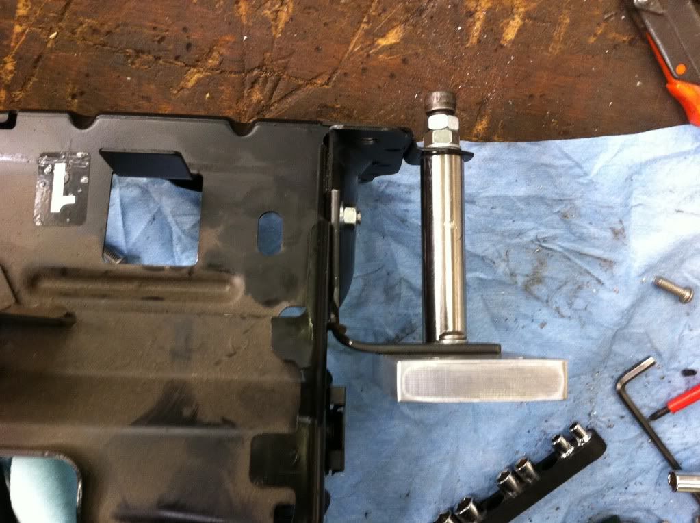

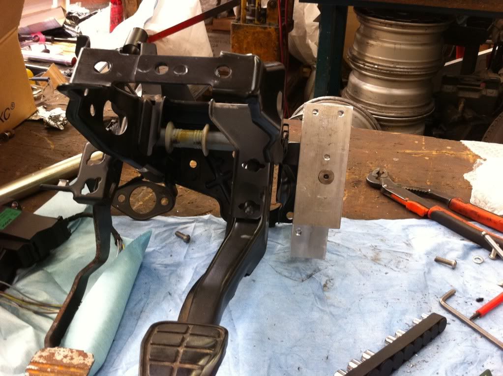

Yesterday Morn I cracked on with the pedalbox bracket
The stem off the back of the new bracket screws into the car once the box is in situ
Put a bolt on the back of the pedal to take the force when at full throttle
And in the car

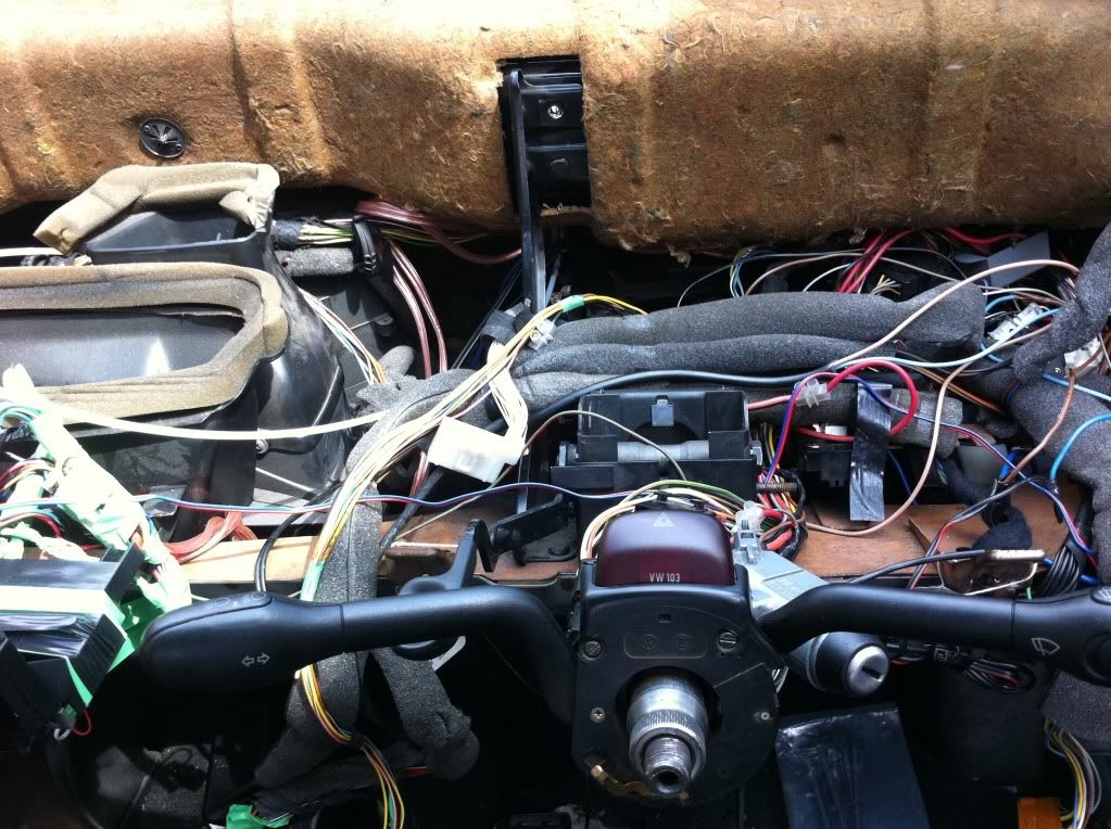

Installed the new adjustable steering column

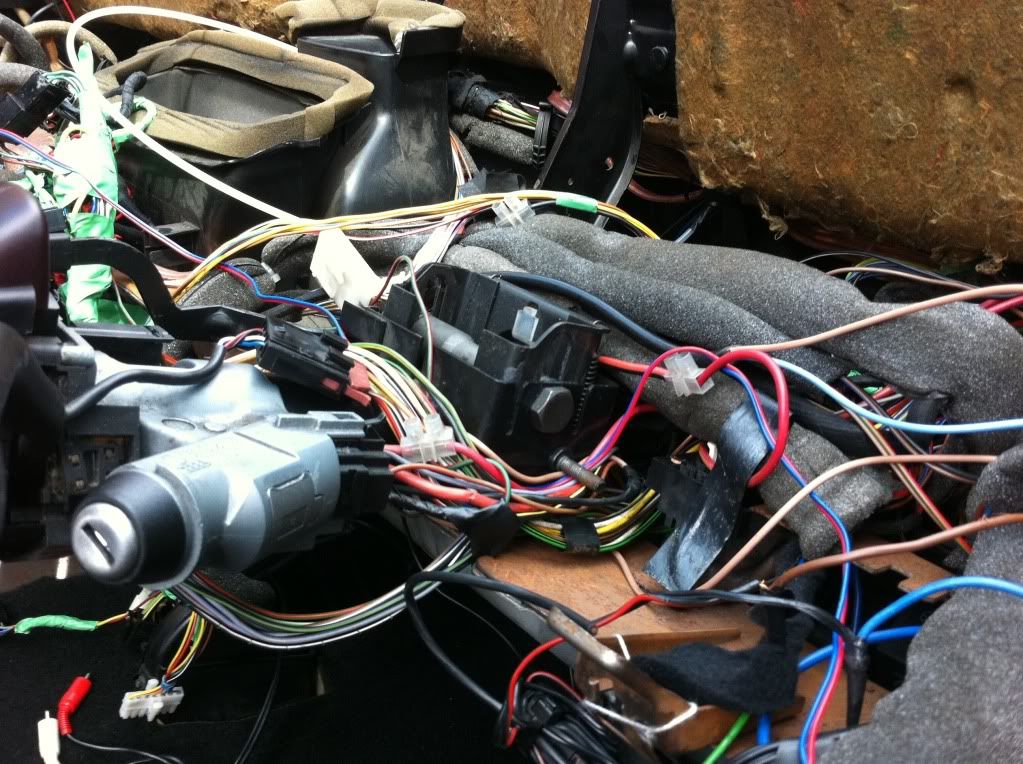

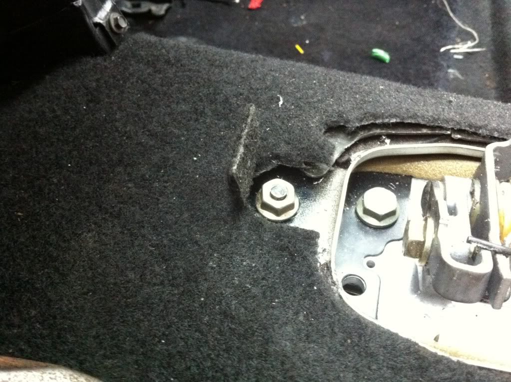

Fitted all the hydro clutch set-up and the new engine mounts today also, had to drill a hole for the cable change shifter box to fit properly, as always my measurements were bang  :rolleyes: on so it looks factory  :cool:
Got the loom in and started putting the inside back together, think Brad has more piccy's so I'll let him post some shizzle up  :grin:

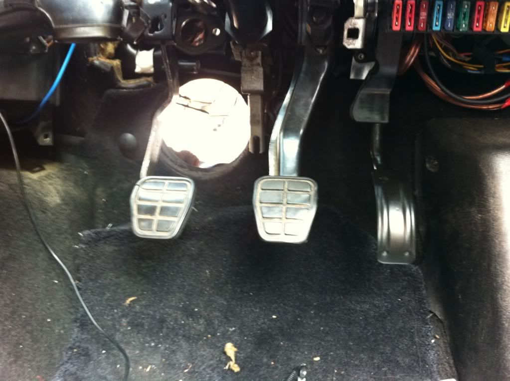

fitted Bens Hybrid Pedal box with the S3 pedal
