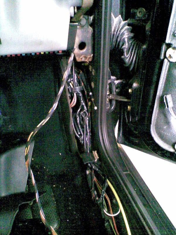

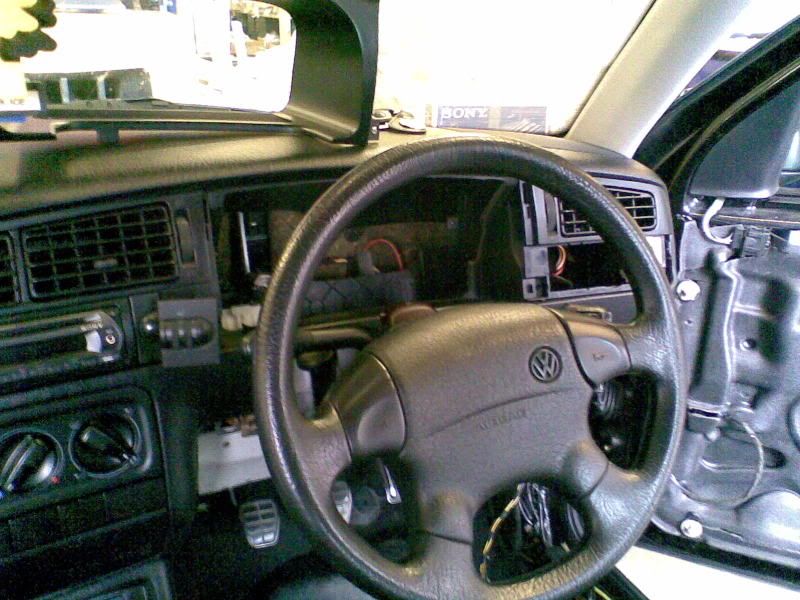

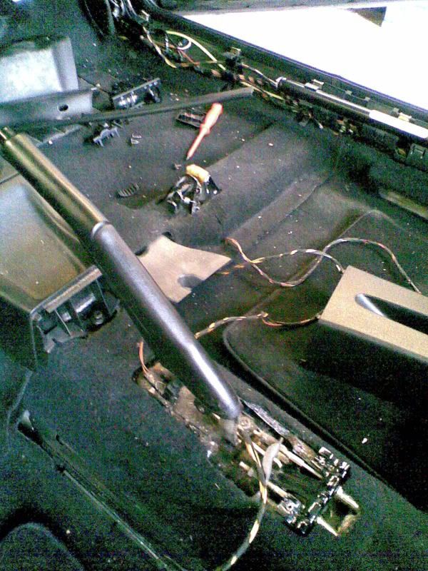

Finally, with a near mint leather interior (door cards as well) it was time to swap out with the 'fake' RECAROS in the GTi. These are heated seats & came with the loom & switch so out came the interior & off with (most of) the dash  :smug:
Running the loom is pretty straight forward, there are a 3 connections, blue/grey, green (with a black wire) & the brown earth. If you pop the light switch out & shine a torch in you'll see where these connect, the rest is just laying behind trim & under the carpet to get it looking smart!
Da daa...
THE END :smiley:
