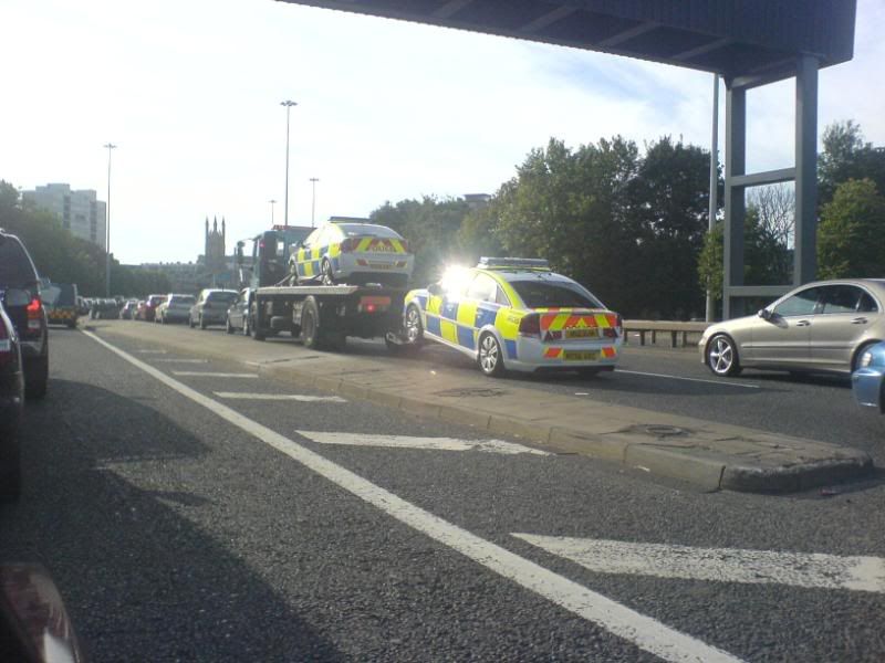

went to go save sal as a water pipe burst on the golf as i was getting onto the mancunian way i spotted these two fomos... i hope they broke down but unfortunatly its more like 2 new traffic cop mobiles on the beat... damn

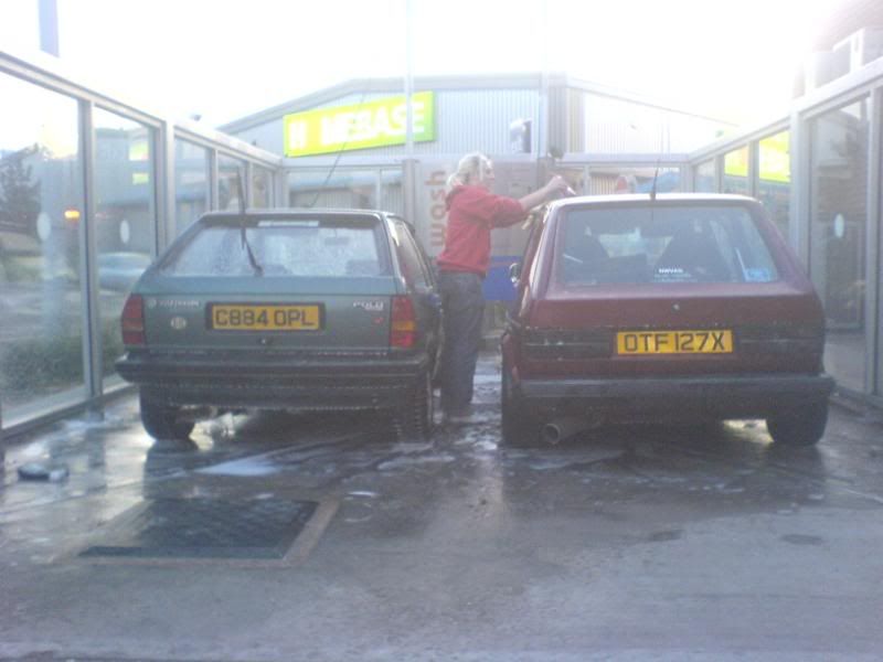

went and washed the cars at a car wash, met a new friend called jet with an audi coupe, apparently weve both inspired him to keep it as its going in the paper saturday for sale, but after seeing our two cars hes determined to make it a minter, go on son!
did our best attempt at some trick photography, but I'm lame hahahahaha! and we were too baked and lazy to go anywhere other than 2metres away from charlies house haha
