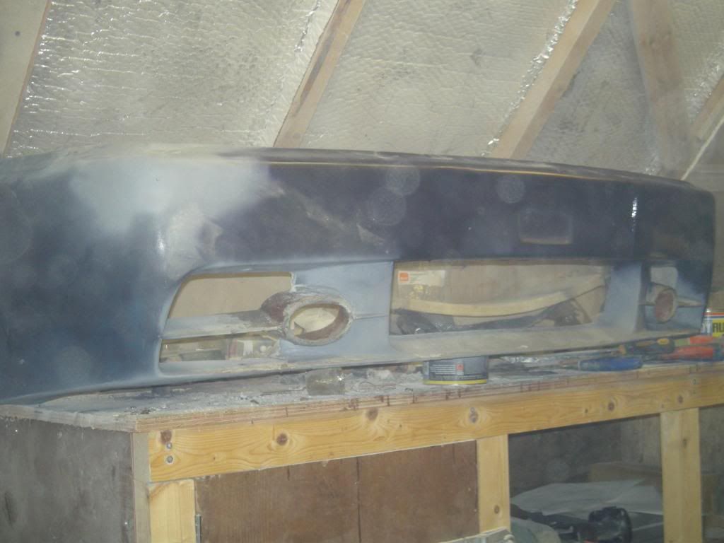

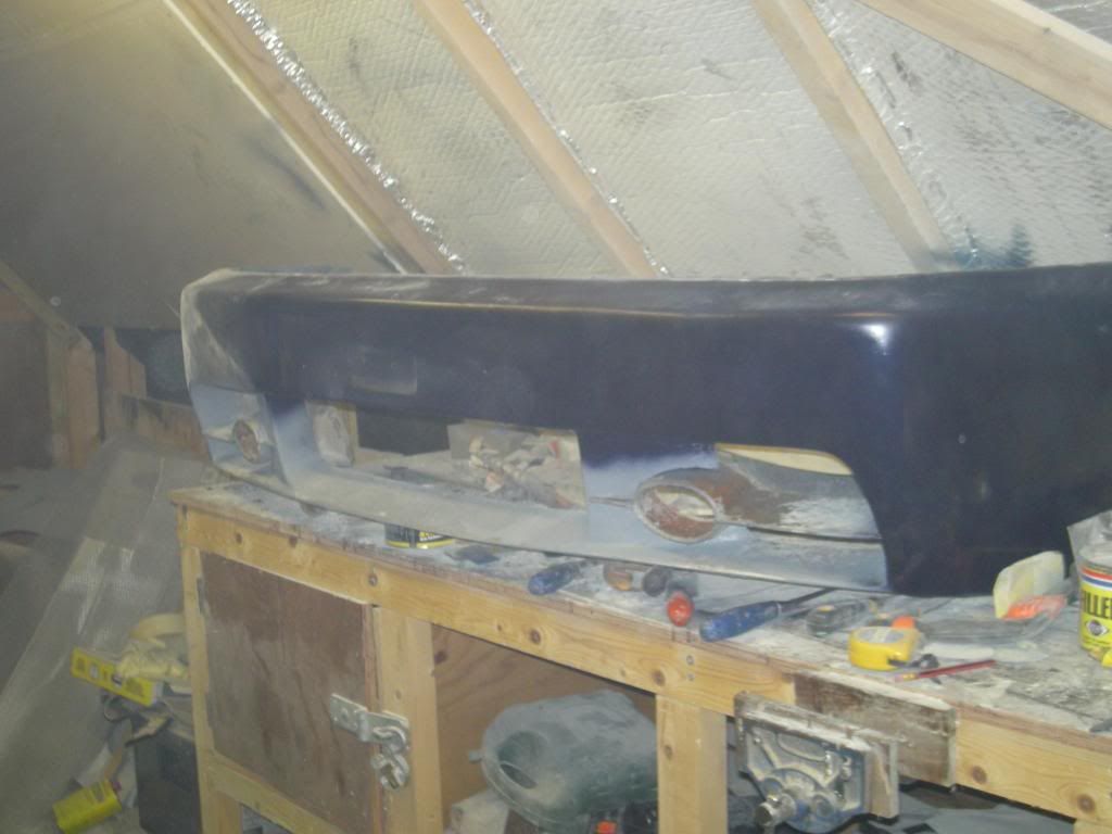

Sweet work on the bumper, ignore people criticizing (unless in jest).. I think its awesome that your putting in the time doing something different and then adapting it to suit how YOU want it! Amazing work with the bumper, was slightly confused when I saw you using the plywood though, thought the only way of filling stuff like that was to do plastic welding, but that looks awesome using that as I guess it bends pretty easily into shape and then just a bit of filler over the top to give the exact shape? Either way, its wicked :)
How have you made the plywood stay in place where the indicators/fogs were? (If its filler as you did with the splitter, then cool, I didnt know it was that strong) :)
Yes I used filler to glue in the thin plywood in the fogs/indicator hole. I used thin ply and bent it using the structure behind and a bock of wood. Then heavy tape over the ends to hold it down whilst the filler set. Then I fiberglassed over all of it! Then some filler on top to get it smooth.

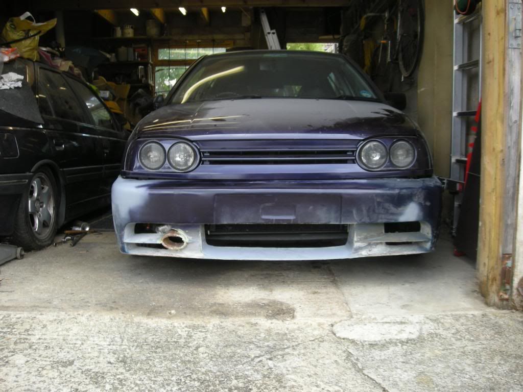

Right just for Shaun!
Thats with only one of the fogs surrounds fitted.
And yes it probably does need lowering! :grin:

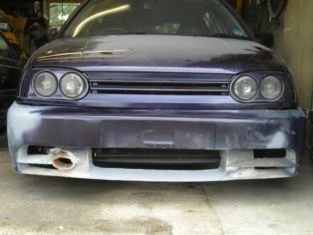

And here's how I left it this afternoon
With both fogs surrounds fitted and glassed in.
Just have to do a little light filling and sanding and final paint!

Looks good mate. How low will it sit to the floor with the new bumper?

Will a splitter of some kind be attached below that?
See the two pics above!
That wasn't in the plans but now looking at the pics........
Have to see after I have wound it down a bit!
I could almost get a Vr6 splitter below that atm! :undecided:
