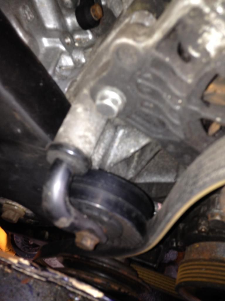

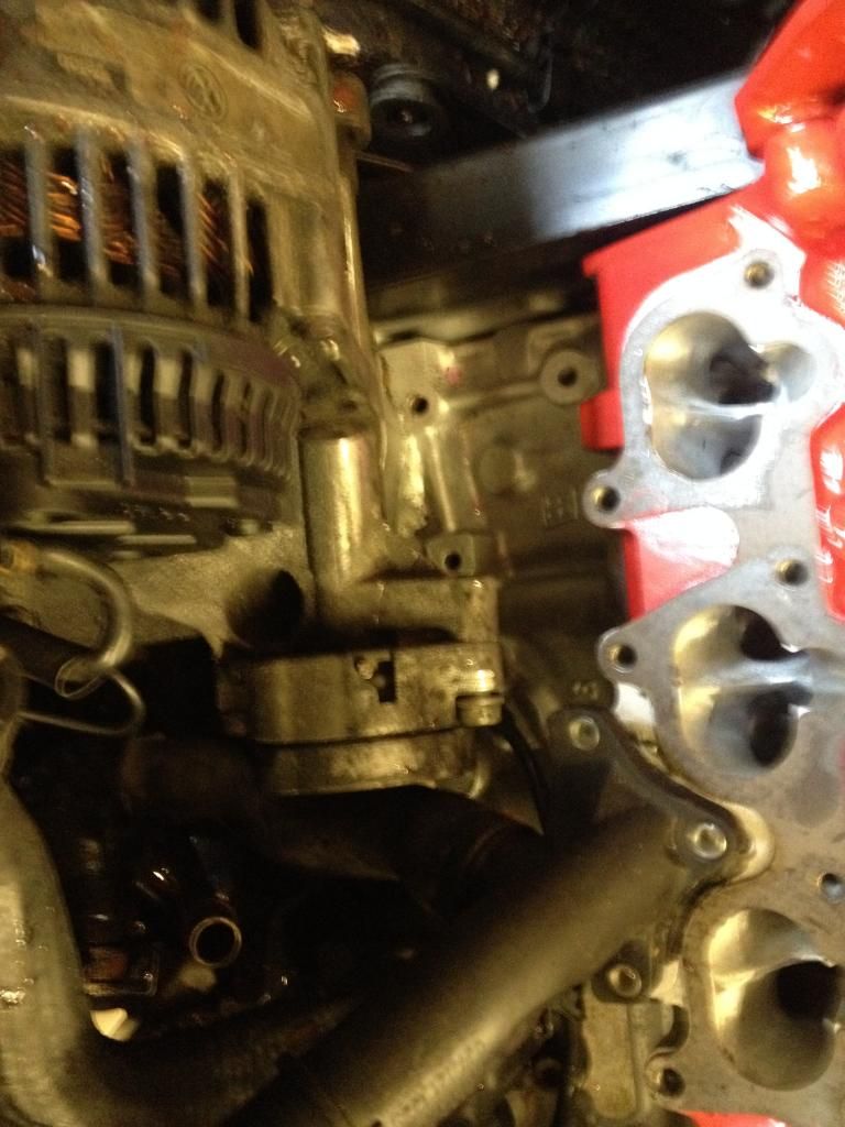

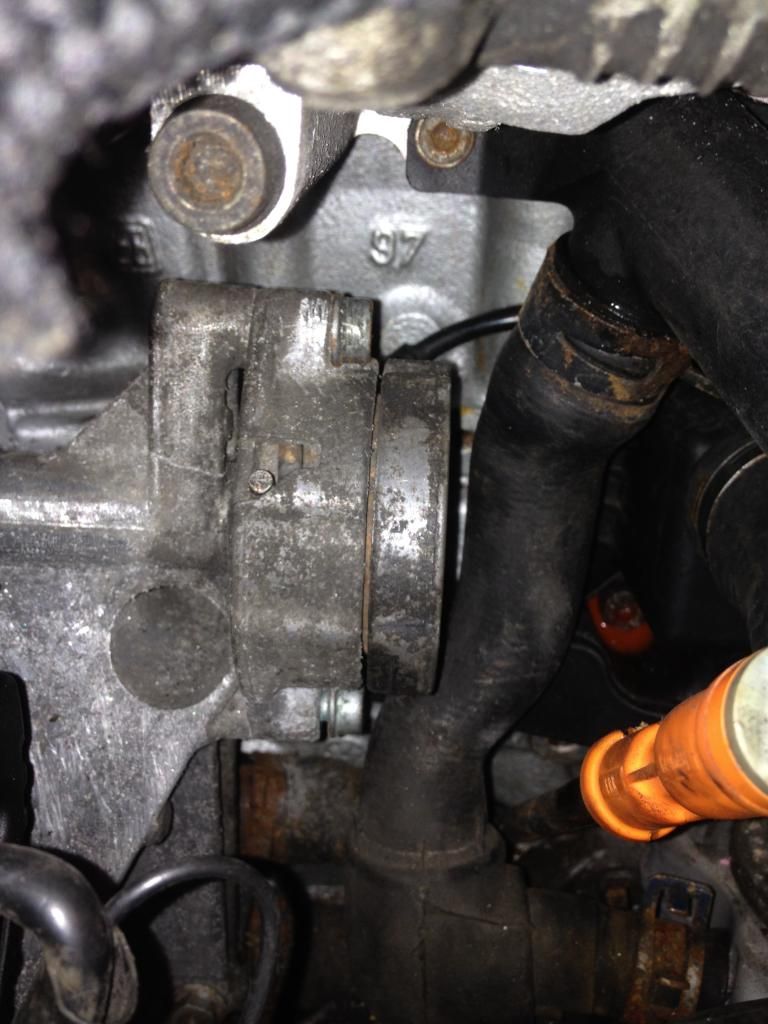

Well i started it but got frustrated coz of having to take inlet manifold off to get to main belt tensioner.
Few pics of the culprit
On the belt end
two bolt end that has to be turned to get the tension

All the pipes were in the way of getting to the two bolts, so inlet manifold off, coolant drained from top of engine by taking off top hose
Its a flippin nightmare!
I know how hard it is to get that tensioner to sit back in place aging so need the space above for leverage room!
